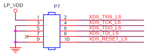

I've been trying for days to debug my f28p65x Launchpad through an external debugger LP-XDS110 (I'm doing since i wanted to test the debug probe with a simple pcb as the Launchpad before using for another project).
I removed the two jumpers which bring power from usb to mcu and I supplied the Launcpad through a dc power supplier with 5v (in order to use an external debugger).
Then I connected TMS, TCK, TDO, TDI, VREF, GND and XRS to the 14-pin connector placed on the F28P65x. I'm attaching a photograph of the rough setup.
When i try to test the connection in the target configuration file, I get the following script:

    I'm sorry to hear that you are having this problem, but I do not recommend that you use the 14-pin header on the F28p65X launchpad. It's header does not follow the TI 14-pin standard, and you would need to create a custom converter to use this header. Please see the f28p65X launchpad schematic for more details.

    I noticed that unpleasant fact concerning the pinout of the TI 14-pin connector.
    However the LP XDS110 and the 14-pin connector on the launchpad perfectly share 10 out of the 14 pins (the last 4 pins are for uart tx and rx and gnd purposes).
    LP XDS110 has an ARM connector made of 10 pin and the Launchpad has the same connector + 4 pins (I attach a screenshot).
    Basically:
    I used a 14-pin flat cable: it properly fits on the LaunchPad side and I avoided to connect the last 4 pins on the XDS110 side (I didn't bring any rx/tx signal from XDS to F28P65X).
    To answer your question : yes, it's exactly what I'm trying to do. Maybe I used the term 'debug probe' improperly. By that I mean the LP XDS110.
    As I mentioned I'd like to use the LP XDS110 on a custom control board and also in that case I'm facing issues. For this reason I made a step back and tried the debugger on a LanucPad first.
    I hope it's more clear now, sorry about that.
    Are you aware of any other reason that could cause this error?
    Thank you!
