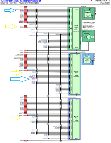

I design an experimental board where I want to bring 3 analog signals to two different internal ADC subsystems (ADC-A, ADC-B). I work with the technical reference and the SysConfig tool v5.04.00.00 (online).
The figure 6-47 indicates that ADCINA1 is the input for ADC-A ch. 1 as well as ADC-B ch. 19 (highlighted with blue arrows in the attached picture). However, when I try this configuration in SysConfig tool I get a warning that the selected channel has no device pin.
Additionally, the name of that pin in the device datasheet is only A1.
However, the very same situation happens with signals A14, A15 (highlighted with yellow arrows). These pins have label A14/B14/C14 and A15/B15/C15. I also won't get any warning in SysConfig.
The question is, if I can truly rely on figure 6-47 and assume, that ADC-B sees analog inputs ADCINA1 on channel 19, etc.
Are there any fundamental differences between pins A14/B14/C15 that are clearly wired to all ADC subsystems compared to ADCINA1 that shall be too wired to multiple ADC subsystems?

  • Hi Jiri,
    The idea here is to provide more flexibility in design in way that we can have access to the same signal in different ADC. For example, in safety application, you can compare your results to see if ADC is working properly.
    On the warning in the image, I am letting the team internally to update it. It will be revised in next revision.
