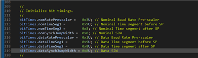

The current bit timing values for 500Kbps and 1Mbps are:
bitTimes.nomRatePrescalar =     0x3U; // Nominal Baud Rate Pre-scaler
bitTimes.nomTimeSeg1 =            0x9U; // Nominal Time segment before SP
bitTimes.nomTimeSeg2 =            0x8U; // Nominal Time segment after SP
bitTimes.nomSynchJumpWidth = 0x8U; // Nominal SJW
bitTimes.dataRatePrescalar =      0x1U; // Data Baud Rate Pre-scaler
bitTimes.dataTimeSeg1 =             0x9U; // Data Time segment before SP
bitTimes.dataTimeSeg2 =             0x8U; // Data Time segment after SP
bitTimes.dataSynchJumpWidth = 0x8U; // Data SJW

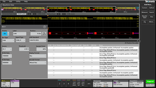

  • I have tried configuring it the with SysConfig file by opening MCAN Bit Timing calculator, it says "Cannot find excel".
  • I have used the provided TI's MCAN_BitTimingCalculator excel file to configure the desired Bit Timing (Nominal Bit rate as 1 Mbps and Data Bit rate as 5 Mbps). Those values  then feeded to the respective parameters. Shown in below screenshot-
    After feeding these bit timing values and  watching the signals on Oscilloscope, unable to watch the data signals there. Below is the Oscilloscope screenshot attached-

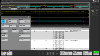

    Now attaching the TI MCAN transmit example number 9(Nominal Bit rate 500Kbps and Data bit rate 1Mbps) screenshot which works fine and able to watch the data signals on oscilloscope too-
    Data visible clearly on oscilloscope-
