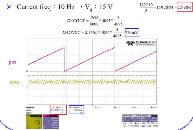

I am currently using the LAUNCHXL-F28379D development board, connected to a three-phase inverter controlling a motor. The system setup is as follows:
  • Current frequency: 10 Hz
  • ADC interrupt frequency: 10 kHz
  • Motor specification: 8 poles, expected speed of 150 RPM (verified with a tachometer)
  • Encoder resolution: 10000 CPR, using only A/B phase inputs without the Index signal
  • eQEP initialization: Based on the official example Eqep_pos_speed.c
  • When manually rotating the motor for one complete revolution, the oscilloscope shows a correct and complete waveform, confirming that the encoder signals are not faulty
Problem:
  1. When outputting the QPOSCNT value as an analog signal via DAC, the expected frequency is 2.5 Hz (corresponding to 150 RPM), but the actual measured frequency is 6.8 Hz.
  2. When increasing the current frequency to 20 Hz, the frequency corresponding to QPOSCNT becomes 7.8 Hz, still much higher than the theoretical value.
  3. The same eQEP initialization configuration (including QUPRD, UPPS, CCPS, etc.) works correctly on the TMS320F28335 platform, with output frequency matching the theoretical value.

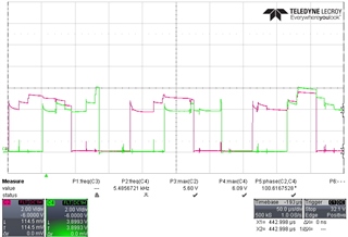

  • Hi Odamate,
    Additionally, the Phase Error (PHE) issue persists despite these changes
    Can you scope what your input signals are? Are they phase shifted by 90 degrees? Is this the only error now that persists?
    Ryan Ma

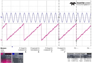

  • I have attached the AB input signals, including those captured during manual rotation of the motor and while the motor is running (which includes some additional noise). Additionally, I’ve provided the monitoring window for the QFLG register.
    I have also modified QUPRD=100, and observed that the PHE flag repeatedly appears and disappears. When manually rotating the motor, the QPOSCNT frequency seems correct. However, at 150 RPM, the QPOSCNT frequency becomes inaccurate and fluctuates.
    Could you kindly help identify the possible causes of these issues? Your advice would be greatly appreciated.
