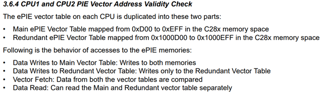

Dear all,
    I'm learning the capabilities of the 377D.
    Regarding the "NMI Vector Fetch Mismatch", I know that the redundant vector tables and vector tables not match will trigger this NIM.
    I would like to ask what causes vector tables to not mach?
    By wrong application code? Or hardware error?
