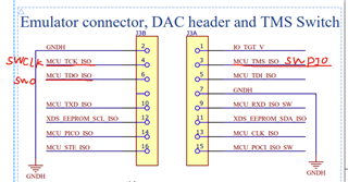

And see the below link for where SWDIO / SWDCLK / SWO applies on our JTAG headers:
Section 4.1.2 of: https://www.ti.com/lit/ug/sprui94/sprui94.pdf

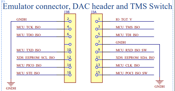

Which is nTRST?
I'm not familiar with the schematic you posted. Where is it from? In any case it would correlate to whatever is reset pin.
It is XDS110ISO-EVM Schematic.
https://www.ti.com/lit/pdf/sprr505?keyMatch=sprr505&tisearch=universal_search
Thanks.

The XDS110-ISO cannot be used for SWD because the RST pin required for SWD is missing. If the version of XDS110 can be updated, hope it can support SWD.
