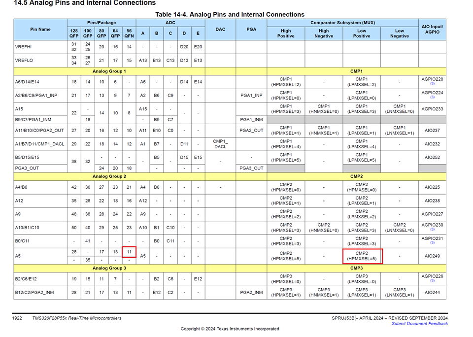

TMS320F28P550SJ: Sysconfig setting not match with datasheet in A5 for CMPSS2LP in 56RSH
Part Number: TMS320F28P550SJ
Other Parts Discussed in Thread: SYSCONFIG, C2000WARE
Hi champs,
I am asking this for our customer.
In the datasheet SPRUJ53B, it shows A5 is with HPMXSEL=5, which appears wrong. Is it LPMXSEL=5?
It shows A5 for HPMXSEL=4, LPMXSEL=4, and both are different from the above and the below Sysconfig GUI.

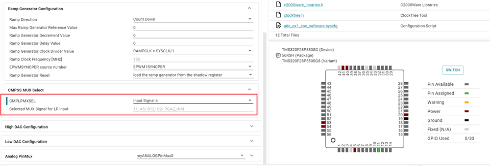

In Sysconfig GUI, (CCS 12.8.1 + C2000ware V5.04)
but the user finds it function does not work.
Which one is correct?
