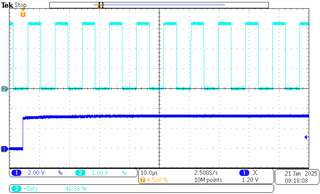

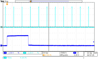

  • Hi Skyler,
    Thanks for your feedback!
    My customer has recorded some experimental data and waveforms.
    Please help resolve this issue. Thanks!
    Code:
    Use debug mode in CCS
    Look at PC, it is in Flash.
    Ch2 is ISR process time.
    However execute the same program after flashing it onto the chip.
    The interrupt execution time(ch2) becomes much longer.
    Use ramfunc
    Check PC, it is in RAM.
    Execute the same program after flashing it onto the chip.
    The interrupt execution time(ch2) becomes much shorter.
    Same as use debug mode in CCS.

  • Ch2 is ISR process time.
    Hi Seamus,
    Is this the correct image? This looks like the same execution time as shown below.
    What happens in ADC_Value_Update()? Is it executing in RAM or flash? Do you see the same behavior is you place that function in RAM every time?
    Kind regards,
    Skyler

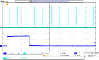

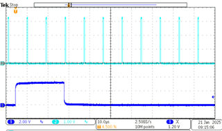

  • Hi Skyler,
    Sorry for the wrong image..
    The first one should look like below image

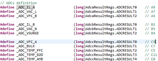

    Just get ADCs result and the code is as follows.
    PC = 0x0861F7. Run in flash.
    Place ADC_Value_Update() to RAM by ramfuc. PC = 0x011486
    Run debug mode in CCS
    Flashing it into chip
    Seamus

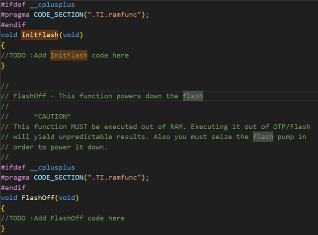

  • Hi Seamus,
    Apologies for the delay. When you load the program to the device via CCS, can you try calling Flash_disableCache() and Flash_disablePrefetch() after device initialization? Additionally, make sure that Flash_initModule() is not being called after you disable the cache and prefetch mechanisms.
    Kind regards,
    Skyler
  • Hi Skyler,
    We found that there is nothing written in the InitFlash() function, now I just suggest customers to use Flash_initModule() instead of InitFlash().
    I want to know:
    1. Are these two funcs exactly execute the same thing, with only differences in API and bit field style?
    2. When will we complete this InitFlash() function in P55 ?
    Seamus
  • Hi Seamus,
    1. Yes, generally the only difference between initFlash() and Flash_initModule() is the driverlib vs bitfield style.
    2. These functions will be completed in the next C2000Ware release.
    Does using Flash_initModule() in the application create consistent ISR performance when loading via CCS and the bootloader? Or does that still need to be investigated?
