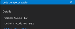

Thanks Diego.
I updated to CCStudio 20.0.1.4 but the issue with MCAN SysConfig persists.
