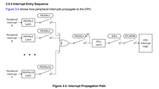

I have driverlib based project and I use ADC C that is triggered by an PWM channel. It works well. As you can below code, I acknowledge the group.

I just want to directly acknowledge the INT1.3 and not the all group 1. Can you provide me code section for this one? As a reminder, I use driverlib based project.

    Each ACK only correlates to a specific ePIE group. There are no ACKs for individual interrupts inside groups. Each time an ISR is branched to, the ACK for the entire group will be "opened" automatically, which blocks other interrupts from the group from propagating during the execution of the ISR.
    I would recommend keeping your code as is, this is the recommended use.
