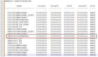

We are generating CM build images using the ARM Hex utility with the following options:
--fill=0xffff --memwidth=16 --romwidth=16 --diag_wrap=off --boot --gpio8 --binary
This image is intended for firmware updates to the on-chip flash memory.
Below is the block information related to this issue. The length is 2 bytes, and the address corresponds to 0x20082F20 (which pertains to the MSGRAM region).
Could you clarify why the binary image generated via the Hex Utility contains block information related to the MSGRAM?
Additionally, is there a way to remove this block information?
If any configuration adjustments or utility-specific settings are required, please let us know.
