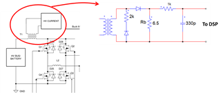

We are designing a 3kW DC/DC power converter based on the TIDM-02000 reference design, and we have encountered an issue during the aging experiment. The converter experiences a short circuit after running for about 30 minutes under full-load operating conditions.

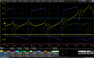

Below is a waveform captured just before the occurrence of the short circuit:
                                      <Control variable is Iinput, not Ipri>
<Fig. 1: Experimental results showing short circuit operation at full-load condition>
Blue waveform: Transformer primary current (Ipri).
Red waveform: Input current (I_Iinput)

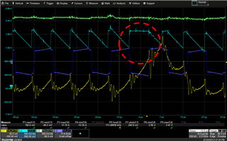

From Fig. 1, we observed that just before the short circuit, the pink gating signal fails to turn off earlier than the light green gating signal, as expected.
We suspect the short circuit is caused by insufficient slope compensation. Currently, the slope value is set to 13. We increased the slope compensation value to 23, which extended the operating time. However, the converter still tripped after a longer duration (Short circuit). So, we concluded that the slope compensation may still be inadequate, though other issues cannot be ruled out.
From the TI Design Note (PMP23216, Page 11), the following information about slope compensation is provided

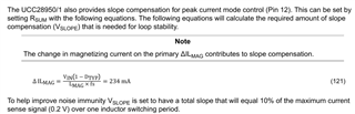

In another reference design (slua560d) (UCC28950 600W Phase Shifted Full Bridge Design Review/Application Report (Rev. D))
the slope value is determined based on change in the magnetizing current.

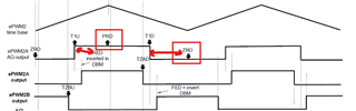

    I think your issue is here:
    Maybe that is what you meant by "the pink gating signal fails to turn off earlier than the light green gating signal, as expected"?
    In any case, if you followed TIDM-02000, then the CMPSS module generates the trip events to the PWM. The PWM action qualifier and trip zone logic will then switch its outputs based on that trip event to achieve the phase shift. It is true that the ramp slope of the CMPSS will impact the timing of the trip event. However, making the ramp faster (increasing slope value) may not be the answer.
    Previously when we have seen similar issues, there are two possible culprits:
    - Incorrect configuration of the CMPSS trip logic. Specifically the digital filter settings in the CMPSS. Incorrect filter setting can filter the trip event to the PWM, causing wrong PWM outputs. Can you share your CMPSS configuration?
    - Incorrect PWM action qualifier or trip-zone configuration. Incorrect AQ/TZ settings can cause incorrect PWM outputs. Can you share your AQ and TZ PWM settings?

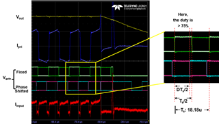

  • Thank you for your detailed response and guidance. Based on your suggestion, I’ve reviewed our CMPSS configuration and PWM Action Qualifier (AQ) and Trip Zone (TZ) logic settings. Below are the relevant configurations from our design:
    1. We use the following configuration for the CMPSS module (specific to the phase-shifted full-bridge control logic:

    I checked CMPSS TRIPOUT signal again.
    Below waveform is measured when output load is fixed.
    Output voltage is operating normal, than suddenly happened peak voltage.
    When happened peak voltage, Icommand dose not change.
    And Main transformer current is increase. also MCU input Main transformer current increase too.
    But There is no CMPSS TRIPOUT signal.
    What do you think?
    CH1 12Vmain
    CH3 CMPSS TRIPOUT signal
    CH4 MCU input Main transformer current
    CH6 Main transformer current
    CH8 Icommand
    Sangmo Kim.
  • Hi, Let me describe Sangmo's Comment in more detail.
    This matter is extremely urgent and we would greatly appreciate a prompt response from TI in order to resolve this issue.
    Below are more waveforms of the trip signals (CMPSS --> X-BAR Output --> GPIO (Trip Signal)).
    The width of the trip signal gradually decreases and as the duty reaches near 50%, it is completely disappeared (Trip Pulse 3 is missed below).
    <RED Waveform: Trip Pulses, Yellow: Tr Pri Current>
    Pulse 1 width: 77.9ns.
    Pulse 2 width: 29.9ns
    This is unusual, and as can be seen, due to missing a trip signal, the ePWM modules does not turns off the PWM. And it is contineous, and the pattern repeats.
    1. What could be the reason for this behaviour and how can we solve it?

    If Duty time is near the 50% duty, Is there a way to force PWM off?
    2. For PCMC, how can we add some limit on duty (as the current is compared realtime with the reference). Is it possible to use some condition in the ePWM module. Like if some trip signal is missed, then don't wait, and turn off the PWM after some specified time.
    Yes, of course. In a phase-shifted system, the CMPSS event will force the PWM output high or low depending on which half of the PWM cycle you are on (see waveform below). The PWM is further configured to set the PWM high or low using the PRD and ZRO events. In the event that the CMPSS trip does not come, the PRD and ZRO event will still ensure the PWM output goes to the right state & should ensure the duty cycle is not greater than 50%. I had checked this configuration in your PWM settings, but please double check to be sure.

    Seemingly HV current is monitored via FB resistor divider primary T1, low voltage +/- input signal to analog block CMPSS. If the DACVAL-L output was not inverted could explain why CMPSS does not produce CBC pulse to PWM2-A/B, thus duty cycle (green signal) driving output current upward to handle sudden DC load primary T2. If nothing changed T2 primary or secondary DC load (30 minutes into testing), if not dead band timing perhaps CMPSS configuration issue.

  • 1. We are using Teledyne Lecroy (HDO8038) oscilloscope, and the setting seems to be ok for sampling.
    As we repeated the experiment several times, this phenomenon is occuring contineously as soon as we start the experiment, and its periodic in nature. So, we can conclude that it is not linked with temperature. We just captured a single instance in our above result. you can see the trip pulses generated by the CMPSS. Just before the missing trip, the pulse width gets weak and weak. Ultimately, it diminishes.
    2. The MOSFET leg is not getting short (no shoot through) as the Tr Pri current is increasing, and showing signs like saturation.

  • Let me share a more clear experiment picture of our problem.
    Ch8: (Orange) CMPSS Trip Pulse
    Ch4: (Green) Sensed input Current used by DSP for PCMC
    Ch6: (Blue) Trans Pri Current
    Ch1: (yellow) Output voltage
    Here, please see the orange pulses, and the green waveform (sensed input current).
    After the fourth Orange Pulse from the left
       - The input current (green) does not fully go down to zero
       - The tr Ipri (blue) also reaches its final value due to almost full duty (50%)
    For the subequent cycle, since the Iref is fixed, the converter should have stopped, as now the current started from a higher level than before. However, it continues to increase and it seems like the reference value is not crossed by the sensed current, and no pulse is generated.
  • Based on the information provided, I believe the issue is that the CMPSS pulse is clearing too quickly for the PWM to properly latch the event. I don't see a waveform from you which shows clearly shows the relationship between MCU transformer current input, PWM output, CMPSS trip output, and icommand. Therefore, I cannot validate my suspicion conclusively.
    For clarity, the CMPSS trip pulse length is indirectly controlled by the CMPSS digital filter. When the comparator goes high, i.e. when the MCU transformer current meets the DAC value, the digital filter will start registering 1s, and the CTRIPH to the PWMs will go high (assuming CTRIPH is coming from the async path). When the digital filter counts 1s >THRESH, it will set its output high. This will in turn reset the RAMP to its maximum value which will mean the DAC voltage is > transformer current, and the comparator output will go low, which in turn will cause CTRIPH to the PWM to go low. I understand this may a bit confusing, but if you study the CMPSS chapter in the MCU TRM it should become a little clearer.
    Bottom line, the digital filter must be configured such that it holds the CTRIPH signal for at least 3 TBCLK PWM cycles.
    "A minimum of 3*TBCLK low pulse width on TZn inputs is sufficient to trigger a fault condition on the ePWM module. If the pulse width is less than this, the trip condition cannot be latched by CBC or OST latches."
    It is important to keep in mind the module clock frequencies here. The CMPSS digital filter operates at SYSCLK/CLKPRESCALE.
    The PWM is operating at TBCLK.
    I would suggest you review the clock divider settings in CMPSS and PWM. Then adjust the CMPSS digital filter to ensure the minimum 3 TBLK cycles required by the PWM. You can also bring out the ASYNC CMPSS trip to the GPIO so you can see exactly what the PWM is seeing and can further validate if the CMPSS is meeting the 3 PWM cycle requirement.

      So current detection HV circuit into DACL has to monitor negative zero crossing power line events for CMPSS DACL output XBAR signal driving PWM2-A/B DACL trip H or L events. PWM DAC trip timing also and seemingly correlates with dead band generator, where PWMA drive is inverted to create PWMB drive and relative to AC current produce by zero crossing switched H bridge primary T2. PWM drives should be somewhat synchronous to AC line disturbance events, <=1µs CBC fault trips both PWMnA and PWMnB.
  • Genatco, this is a DC to DC application. There is no zero crossing events because there is no AC current. The transformer current does go through positive and negative cycles, but the current signal is rectified before it is delivered to the MCU.
  • Hi Gus,
    Right, do see DC-DC converter. Note TP3 (CS_HV) no electrolytic capacitor filtering HV pulse/s diving DC pulses below ground during surge condition flyback T1 with DC battery source derived AC line powered M1-M2. Anyway, odd part of above captures PWM1/2-A/B signal above scope captures (duty cycle) PWM-A not so much B reduced or inverted or visa-versa. Why did other arbitrary channels remain at 50% duty cycle if CMPSS configured analog MUX could drive 4 PWM DAC channels? Would it not be prudent to do a CBC current limit on all four PWM channels driving phase shifted zero switched Full Bridge? Why not CMPSS set to trip High, inverted output matching DCAL, DCBL multiple combination trips? Seemingly configuration below delays async trip events >50µs @20KHz next PWM switching cycle, deadband band generator suspected. Perhaps adding MOV across AC power line inputs M1 & M2 could reduce line transients. Suggest scope TP3 see what is going on in HV_FB during disturbance.
    Note customer urgency, TIDI-2000 module is not to be resold and or used in any part of consumer devices. Example software provided as is, may require debugging and or modification to fine tune device operation to the satisfaction of the developer.

    We already tried fully removing this RC filter (R32, 1kohm and C23 330pF) to remove the delay in TP3. However, the missing pulse still occurs.
    With RC filter having (1k, 330pF) values, filter's cutoff frequency (fc) is 482kHz. With your suggested (1k, 100pF), fc is 1500kHz, means little to no filtering.
    However, we suspect the problem is linked with CMPSS settings. We will can capture TP3 and Trip pules signal again, but it seems that we already know how it will look as we already have the waveforms above.
    Thank you
  • Here, 8 (i.e., 0000 1000) is the correct value for selecting ePWM 5 as the sync source. To select ePWM 9, we must use 18 (i.e., 0001 0010).
    The first LSB is ignored, as it is meant for the DACSource and must be 0. The next four bits determine the Ramp Source. In case of ePWM 5, it is 0100 (i.e., 4), which corresponds to ePWM 5.
    After carefully reviewing the waveform (and the DACHVALA values from the ramp plot), we suspect that the Trip Pulse and the ePWM sync are occurring simultaneously, btw, is it possible??
    As a result, the ramp generator resets, but however, it seems to ignore the ePWM sync value for starting the countdown process.
    What are your thoughts on this?
  • With RC filter having (1k, 330pF) values, filter's cutoff frequency (fc) is 482kHz. With your suggested (1k, 100pF), fc is 1500kHz, means little to no filtering.
    Yet TI circuit HVFB you posted is not the one shown TIDM-02000; Schematic has full wave bridge rectifier primary side. Secondly reducing 330pF will increase HVFB pulse response window, shorten signal falling edge. So, it ignores random periodic spikes your scope will indeed fail to capture in continuous trigger mode.
    That was primary reason for suggesting circuit change but you can do simple transient detection test on TP3. Set scope channel single trigger mode, negative (-200Mv to -500Mv) just to be sure a very rapid transient pulse is not escaping continues trigger captures. Some if not most transients can be in the megahertz range. We add inline ferrite bead chips being very effective arresting high frequency ringing transients riding on DC signals.

  • The first LSB is ignored, as it is meant for the DACSource and must be 0. The next four bits determine the Ramp Source. In case of ePWM 5, it is 0100 (i.e., 4), which corresponds to ePWM 5.
    Yes, you are absolutely right. I misread this.
    It is possible you are hitting a corner case here where the COMPHSTS (ramp reset) is coming after the EPWMSYNCPER signal, causing the ramp to reset and stop until the *next* EPWMSYNCPER pulse. I'll have to check with our CMPSS experts to see if there is a way around this.
  • I discussed with a colleague. It is conceivable that you are hitting the corner condition where COMPHSTS is coming after the EPWMSYNCPER signal as shown in the diagram below.
    Can you capture COMPHSTS and PWM sync signal from PWM5 on the same scope shot with the ramp plot?

  • Yes, the input and output of the analog comparator in the CMPSS is wholly dependent on the current in the transformer. At high phase shift angle, i.e. when the load is high, it is possible for the transformer current to mee the CMPSS ramp close to the end of the CMPSS period, which would coincide with the PWM sync pulse.
    Thank you for your comment.
    I will find to can measure ePWM5.
    I heard about the corner case from Steve at TI Korea.
    When I measured the waveform, I realized that the RAMP reset could be after the RAMP sync.
    I am going to modify and test the ePWM5 with RAMP sync behavior.

  • Before modifying the PWM sync pulse behavior, I would suggest capturing this pulse in the scope while the error happens. Need to be sure this is the issue before implementing any fix for it.
  • Perhaps keep in mind the CMPSSn (Gus mentioned above) has mandated conditions to set CBC latch state, 3 clock cycles. Seemingly SYSCLK being the peripheral clock source CMPSSn and NOT TBPRD clock source of ePWM modules. Again, T1 primary signal may vary asynchronously relative to SYSCLK by several hundred cycles, EURO 200VAC 50Hz supply voltage. Guss please correct me if this text does not apply to the issue in this thread. Setting up edge event delay offset of several microseconds any period might avoid the near SyncI / SyncPER edge MISSING pulse seemingly showing up in the very next PWM period.
    18.11.3 Using CMPSS to Trip the ePWM on a Cycle-by-Cycle Basis When using the CMPSS to trip the ePWM on a cycle-by-cycle basis, steps should be taken to prevent an asserted comparator trip state in one PWM cycle from extending into the following cycle. The CMPSS can be used to signal a trip condition to the downstream ePWM modules. For applications like peak current mode control, only one trip event per PWM cycle is expected. Under certain conditions, it is possible for a sustained or late trip event (arriving near the end of a PWM cycle) to carry over into the next PWM cycle if precautions are not taken.
    If either the CMPSS Digital Filter or the ePWM Digital Compare (DC) submodule is configured to qualify the comparator trip signal, “N” number of clock cycles of qualification will be introduced before the ePWM trip logic can respond to logic changes of the trip signal. Once an ePWM trip condition is qualified, the trip condition will remain active for N clock cycles after the comparator trip signal has de-asserted. If a qualified comparator trip signal remains asserted within N clock cycles prior to the end of a PWM cycle, the trip condition will not be cleared until after the following PWM cycle has started. Thus, the new PWM cycle will detect a trip condition as soon as it begins.
    To avoid this undesired trip condition, the user application should take steps to ensure that the qualified trip signal seen by the ePWM trip logic is deasserted prior to the end of each PWM cycle. This can be accomplished through various methods: • Design the system such that a comparator trip will not be asserted within N clock cycles prior to the end of the PWM cycle. • Activate blanking of the comparator trip signal via the ePWM event filter at least two clock cycles prior to the PWMSYNCPER signal and continue blanking for at least N clock cycles into the next PWM cycle. • If the CMPSS COMPxLATCH path is used, clear the COMPxLATCH at least N clock cycles prior to the end of the PWM cycle. The latch can be cleared by software (via COMPSTSCLR) or by generating an early PWMSYNCPER signal. The ePWM modules on this device include the ability to generate PWMSYNCPER upon a CMPC or CMPD match (via HRPCTL) for arbitrary PWMSYNCPER placement within the PWM cycle
