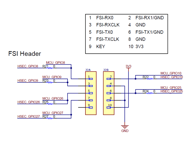

TMS320F28388D: FSI calibration using example code
Part Number: TMS320F28388D
Other Parts Discussed in Thread: C2000WARE, TMDSCNCD28388D
I'm trying to validate FSI connection between two DSPs by following the tutorial provided in the application note. However, the two example codes used in the tutorial: fsi_ex14_dual_line_delay_select_rx, fsi_ex14_dual_line_delay_select_tx and fsi_ex15_find_optimal_delay_device2 and fsi_ex15_find_optimal_delay_device1 are missing in C2000Ware for the F28388D line microcontroller. I was able to locate fsi_ex14 example code for the F28004X family MCUs and made some changes to the code for it to build and run on the F28388D. But the program cannot get pass the handshaking stage. Can someone tell me why this is happening? Thanks in advance.

//!\b External \b Connections \n
//!   For FSI external connection, make below GPIO settings in
//!   example code.
//!  ControlCard FSI Header GPIOs:
//!  - GPIO_27  ->    FSITXA_CLK
//!  - GPIO_26  ->    FSITXA_TX0
//!  - GPIO_25  ->    FSITXA_TX1
//!  - GPIO_9  ->     FSIRXA_CLK
//!  - GPIO_8  ->     FSIRXA_RX0
//!  - GPIO_10  ->    FSIRXA_RX1
//!  LaunchPad FSI Header GPIOs:
//!     - GPIO_7   ->    FSITX_CLK
//!     - GPIO_6   ->    FSITX_TX0
//!     - GPIO_25   ->    FSITX_TX1
//!     - GPIO_33  ->    FSIRX_CLK
//!     - GPIO_12  ->    FSIRX_RX0
//!     - GPIO_2  ->    FSIRX_RX1
