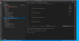

I have a TMDSCNCD28388D board and when i'm debugging CM RAM and CM FLASH blinky on code composer studio, gave mi a strange error doesn't take the file cm.out and I don't know why for CM RAM the debug work but when start runngiong the led doesn't blink, for CM FLASH gave the error that can linking cm.out because I see in the folder that doesn't exsist why?
[2]Building target: "led_ex1_c28x_cm_blinky_cm.out"
[3]Invoking: Arm Linker
[4]"C:/TIWORK/ti-cgt-arm_20.2.7.LTS/bin/armcl" -mv7M4 --code_state=16 --float_support=none -me -Ooff --define=DEBUG --define=_FLASH --diag_warning=225 --diag_wrap=off --display_error_number --gen_func_subsections=on -z -m"led_ex1_c28x_cm_blinky_cm.map" --heap_size=1024 --stack_size=512 -i"C:/TIWORK/ti-cgt-arm_20.2.7.LTS/lib" -i"C:/TIWORK/ti-cgt-arm_20.2.7.LTS/include" --reread_libs --diag_wrap=off --display_error_number --warn_sections --xml_link_info="led_ex1_c28x_cm_blinky_cm_linkInfo.xml" --rom_model -o "led_ex1_c28x_cm_blinky_cm.out" "./led_ex1_c28x_cm_blinky_cm.obj" "./device/cm.obj" "../2838x_FLASH_lnk_cm.cmd" "C:/ti/C2000Ware_5_04_00_00/driverlib/f2838x/driverlib_cm/ccs/Debug/driverlib_cm.lib" -llibc.a
[5]<Linking>
[6] undefined first referenced
[7] symbol in file
[8] --------- ----------------
[9] vectorTableFlash ./device/cm.obj
[10]error #10234-D: unresolved symbols remain
[11]error #10010: errors encountered during linking; "led_ex1_c28x_cm_blinky_cm.out" not built
[12]>> Compilation failure
[13]makefile:139: recipe for target 'led_ex1_c28x_cm_blinky_cm.out' failed
[14]gmake[1]: *** [led_ex1_c28x_cm_blinky_cm.out] Error 1
[15]makefile:135: recipe for target 'all' failed
[16]gmake: *** [all] Error 2
