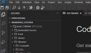

I have the latest version while the document expresses an older version of CCS. I am unable to GRAPH in single time in following the procedure of Lab 1 (C2000Tm Digital Power Buck Converter BoosterPackTm Design Guide (Rev. A)). Going into View > Graph, displays that I must enter an expression that I am not aware of where I can find this. I looked around and most responses direct me to enter User Settings (UI) and add in a JSON file to enable graph time.
EDIT (1/24/2025): I was able to find solution to one of the questions. Inserting the expression name from the watch list will display the result onto the graph. However, I am unable to record the output in either ARM or FORCE trig. It does not display any values onto the graph.
