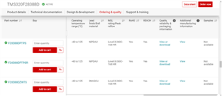

I would like to know the component's lifetime (product lifespan) and the lead time for PN: TMS320F28388D.
Dear Team,
TI Policy on lifespan of devices is here: https://www.ti.com/support-quality/quality-policies-procedures/product-life-cycle.html
Also, Is there any alternative for the PN: TMS320F28388D.
We have some lower cost versions like F28386D, and F28384D. Also there are versions with single F28 core + M4 core.
We may also have other MCUs that will meet your requirements, but we cannot know without knowing your application.
To see lead time, please click 'View' under Additional Manufacturing Information.
