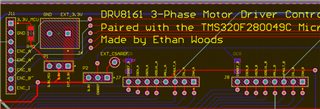

I am using the LAUNCHXL-F280049C with the 100 pin F280049CPZS. I am trying to get a BLDC motor to spin using the launchpad and 3x DRV816x motor drivers. I have built a PCB that is similar to the DRV816x EVM and have jumped the following signals from the launchpad to the motor driver board. The motor driver board takes PVDD (24V 1A), GVDD (12V 1A), 5Vin (5V 1A), as well as 3.3V from the launchpad.

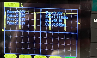

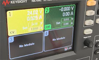

When this code is ran on CCS, these are the resulting waveforms for PWM6A, PWM6B as well as the power pulled from the different supplies.
If I let this ccs code run longer, the mosfets begin to heat up but when GUI code is ran, the 24V supplies pulls around 0.3A.
EPWM6A waveform
EPWM6B waveform
For reference, this is how the waveforms look when using the DRV816 EVM, the waveform also toggles on and off.
PWM6A
PWM6B

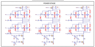

    Perhaps you could download via (CCS REX) Universal Motor Control software example, has GPIO switch function to start/stop motor without GUI, Follow the user guide for MCU conversion for x49c UMCSDK documents folder. Can you post a schematic of MOSFET phase drivers on green board? Note for non-stepper drive motor, PCB only require two NFET for direction spin control via Hall sensors.

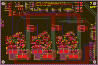

    I've attached the zip of the altium design for the Green PCB (schematic and layout) it is heavily modeled after the DRV816EVM that TI provides.
  • I will also add screenshots if unable to download.
    Entire layout:
    PhaseA:
    Phase B:
    Phase C:
    Close Ups:
    From the launchpad, the signals in the table above are being wired to J8,J9,J10. This configuration works and is able to spin the motor using the TI GUI. However when using CCS to flash code, nothing works.

    It seemed from your post the green board was your own custom design, not copy of TI motor driver DRV8161EVM. Why not add x49c MCU to the larger green board get rid of jumper wires or check TI store for MCU like x25c, x39c?
    Consider twisting few jumper wires with a ground wire, same idea for critical feedback signals, e.g. Halls. The PVDD two extra MOSFETS add design cost that seemingly could be avoided. Being MCSDK does not leverage multilevel PWM phase drive signals. Extra cost two PVDD switches per-phase seems odd for speed/torque control LAB's, not seeing the schematic it is anyone guess why they even exist.
    TI past has never had a motor driver detached from LaunchXL PCB for sale TI store, was only design files provided. Yet the price $229.00 USD seems a bit high over Booster Pack boards of the similar category. Parallel NFETS seems odd for such low voltage/current phase drives. Perhaps consider single NFET can ease PCB space restrictions.
