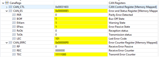

      I've checked the CAN error status register [CAN_ES] and CAN Error Counter register [CAN_ERRC]. I've attached the screenshot of those register for reference.
    Please let me know is that anything I'm missed out during migration and to how to solve this issue. Thanks in advance

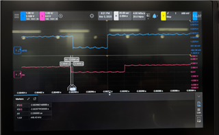

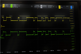

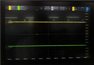

  • Hello Fleenor,
            My Test setup consists of C2000: F28P659SH6 PTP MCU where GPIO 70 and GPIO 71 is connected to Tx and RX pin of TCAN1043ADRQ1 CAN transceiver IC. I've attached the requested screenshots. PFA.
    Launch Pad : CAN_H and CAN_L
    Custom Board:
    1. Tx and Rx:
    2. CAN_H and CAN_L:
    Please let me know if anything else is required from my end.
    Subhash
  • Hello Subhash,
    Thank you for providing these screenshots. Based on this information, it seems that the MCU is correctly configured to provide the correct CAN TX signal, but there appears to be an issue with the CAN Transceiver implementation since this isn't being reflected on the CAN_H/CAN_L terminals.
    Can you provide schematic of the TCAN1043A configuration?

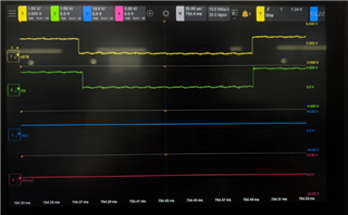

  • Hi Fleenor,
        Please find the answers below.
    1) Can you confirm the state of the nFault pin during this operation?
        Ans: nFault pin state was in Low state. Attached the scope shots below.
    2) Do you have the WAKE pin pulled permanently high or low to prevent unwanted LWU request?
        Ans: Wake pin is pulled Low. Schematic is attached for verification. Wake pin is configured as GPIO output in MCU and set it to output Low.
    3) What is config for EN and nSTB pins?
        Ans: En and nSTB are configured a GPIO output in MCU and set both of them to output High. Scope shot and schematics are attached for verification.

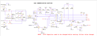

    CAN Schematic:

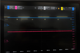

  • Hey Subash,
    Can you expand the Transceiver schematic shot to also show INH, VIO, and VCC connections?
    Based on the information so far, it seems that the issue isn't with the MCU device but likely with the transceiver.
    Can you also provide scope shots of the WAKE signal?
    I am going to reassign this thread to get a TCAN1043 Apps expert to review as well.
    Zackary Fleenor
  • Fleenor,
    Thanks for the help thus far.
    Subhash,
    It looks like your device may be in Sleep mode. As Fleenor suggested, can you please send over waveforms of INH, along with nSTB, EN, VCC, and VIO?

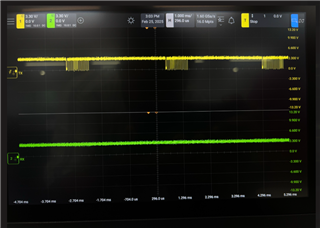

  • Hi Eric,
    I have attached the scope shots of INH, VCC and VIO waveforms below. The waveforms of EN, nSTBN and nFault behaves same, those waveforms were attached in previous response.
    Please have a look and let me know if anything is required from my end.
    Schematic:
  • Hi Fleenor,
    Thanks for the help, I've attached the full schematic of CAN in below response. I'm getting 0V from the wake signal.
    Subhash

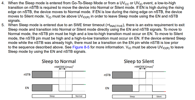

  • Hi Subhash,
    Thanks for sharing that new waveform.
    Because INH is low, this points to the fact that TCAN1043A is in Sleep mode as Eric mentioned. To enter Normal mode from Sleep mode, EN must be high and a low-to-high transition on nSTB is needed. I recommend looking at Figure 8-4 in the datasheet and the paragraphs below it (4 and 5):
    Also please ensure you are using the correct datasheet for TCAN1043A. The other versions have different methods of exiting sleep mode. Once INH, EN, nSTB are all high, then this signifies that TCAN1043A is in Normal mode where TX can transmit to the bus.
    Ethan

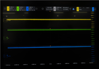

  • Hi Ethan,
          I've attached the waveform image of nSTB, EN, INH, nFault below for your reference. It's captured during startup process. Please let me know if anything else is needed.
    Subhash
  • Hi Subhash,
    Can you clarify what you mean by startup process? Do you mean when VSUP is turned on to a valid level?
    From that waveform, we can see that nFAULT is low. This indicates that there is a fault somewhere in the system which is preventing transmission. There are a variety of nFAULT=low sources so please review Table 8-1 in the datasheet for the cause.
