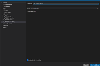

I'm working on migrating from CCS v12 to v20. I'm generating a binary file using the command-line pattern in the v12, but I can't find this option in v20. See images:
I know the setting is still there, because when I import a v12 project to v20 it is still running the flash_generate.cmd file, but doesn't let me control it & I wouldn't be able to port it to another project in v20. Was the command line pattern setting moved somewhere else in v20? I haven't been able to find it looking through the settings.
  • I'm generating a binary file using the command-line pattern in the v12, but I can't find this option in v20.
    The ability to manually modify the command-line pattern in the project properties is not supported in CCS 20.
    It is currently hidden. I suppose you can manually modify the .cproject file for the project but that is a bit user unfriendly.
    What is flash_generate.cmd? It is a DOS cmd file that runs after the hex file is generated?
  • This is the flash_generate.cmd file I was using. I'm able to get most, but not all of these settings through the GUI. I wasn't able to figure out how to setup the ROMS.

  • Instead of enabling the Hex Utility in the project properties, perhaps just manually call it as a post-build step so that you have full control over what is passed to it?
  • I see how to do the post build steps. Would that be doing the same thing as the hex utility? I see an few different examples showing how they did it, but not much explaining how it works. Is there a simple way to just have the post build step run the same thing I was running before?
  • Is there a simple way to just have the post build step run the same thing I was running before?
    Take a look at the build output to see the exact command executed by the project for the hex utility. That is what you want as your post-build step. You should be able to use build variables for some of the text.
  • Ok, I got it set up to generate the hex file correctly that way. Thank you for your help!
