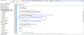

Hi
In my project, I am utilizing two CPUs where CPU1 sends commands to CPU2 via Inter-Processor Communication (IPC). Upon receiving a command from CPU1, CPU2 transmits the CAN data stored in its buffer. CPU2 receives CAN data from an external source. However, I am encountering an issue: when I start or run the code, CPU2 gets stuck during CAN initialization. Upon debugging, the code halts at the can_initialization_RAM section.
I have configured the IPC communication between CPU1 and CPU2 as per the guidelines provided in the C2000 Multicore Development User Guide. Specifically, I have ensured that CPU1 writes data to the CPU1_TO_CPU2 MSGRAM, and CPU2 reads from this location.
below code for CPU1

below code for CPU2

void main(void)
// Initialize Device & GPIOs
Device_init();
// MemCfg_initSections(MSGRAM_CPU1_TO_CPU2);
Device_initGPIO();
// Configure CANB for RX
GPIO_setPinConfig(DEVICE_GPIO_CFG_CANRXB);
GPIO_setPinConfig(DEVICE_GPIO_CFG_CANTXB);
// Initialize CANB Module
CAN_initModule(CANB_BASE);
CAN_setBitRate(CANB_BASE, DEVICE_SYSCLK_FREQ, 500000, 20);
// Enable CANB interrupts
CAN_enableInterrupt(CANB_BASE, CAN_INT_IE0 | CAN_INT_ERROR | CAN_INT_STATUS);
// Initialize Interrupt System
Interrupt_initModule();
Interrupt_register(INT_CANB0, &canbISR);
Interrupt_enable(INT_CANB0);
// Setup RX Message Object
CAN_setupMessageObject(CANB_BASE, RX_MSG_OBJ_ID, 0x1, CAN_MSG_FRAME_STD,
CAN_MSG_OBJ_TYPE_RX, 0, CAN_MSG_OBJ_RX_INT_ENABLE, MSG_DATA_LENGTH);
CAN_startModule(CANB_BASE);
// IPC Initialization
IPC_clearFlagLtoR(IPC_CPU2_L_CPU1_R, IPC_FLAG_ALL);
IPC_sync(IPC_CPU2_L_CPU1_R, SYNC_FLAG);
// Register IPC Interrupt
Interrupt_register(INT_IPC_0, IPC_ISR0);
Interrupt_enable(INT_IPC_0);
// Enable Global Interrupts
EINT;
ERTM;
while (1);
