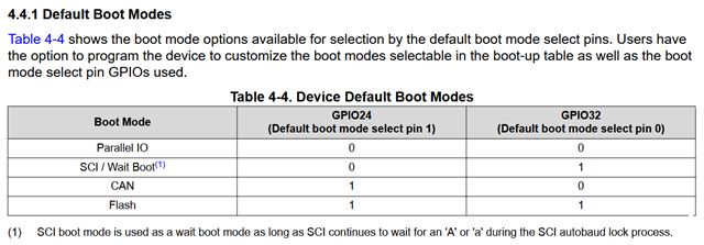

I am trying to build and deploy a simple program on my TMS320F280039C micro controller using the C2000 blockset in Matlab. However, I always keep getting this error,

Does anybody know the solution to this? Just for context, I am connecting the board directly to the CPU using the USB cable that comes with the micro controller. Is that the problem (Gemini tells me this is definitely the issue).
