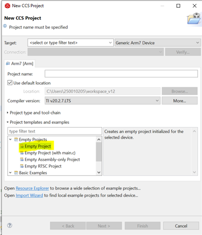

I created Empty Project.

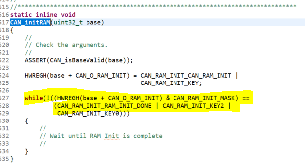

I written application for CAN initialization (CAN_initModule(uint32_t base)).
When i build projects. I am getting bellow warning.
If i ignore waring and flash the code. It stuck in loop. Function mention in below snippet.
Any idea how to resolve or what is issue?
  • Hi Shashi,
    You should not ignore the warnings pertaining to memory mapping in the C2000 compiler. This is saying that you need to define the MSGRAM sections in the linker command file. You can use the dual-core linker command files from our C2000WARE SDK as a base to refer to. Otherwise if you do no have these sections defined, your code may not execute correctly as you have seen
