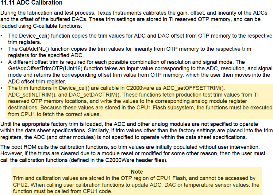

TMS320F28377D: I would like to know whether handling ADC calibration process on CPU2 is acceptable.
Part Number: TMS320F28377D
In the F2837x TRM, section 11.11 ADC Calibration, it is stated that CPU1 must apply trim data for the ADC and other analog circuits.
Does this mean that when operating the ADC or DAC from CPU2, CPU1 must initialize and calibrate the circuit before transferring ownership to CPU2 using the CPUSELx bits?
Looking at TI's F2837x multicore example (device_support/dual/adc_epwm), CPU1 transfers ownership of the ADC circuit to CPU2 by manipulating the CPUSELx bits. Then, in the CPU2-side code, the AdcSetMode() function is called, followed by ADC power-on (modifying the ADCPWDNZ bit).
Since the AdcSetMode() function appears to include code for applying calibration data, I would like to confirm whether handling this calibration process on CPU2 is acceptable.

    It's not okay to handle calibration solely from CPU2. Only CPU1 is responsible for retrieving and applying the correct factory trim values, and it needs to complete the calibration before transferring ownership. In the example given, if "AdcSetMode()" is called from CPU2 before CPU1 has set the trim values, the calibration could use incorrect values, since CPU2 doesn't have access to those OTP locations. I believe the example mainly illustrates peripheral sharing rather than complete initialization, and I'll check with our expert to verify this.

    As far as I understand, that in order to meet the ADC specifications presented in the F2837xD's datasheet, the calibration routine included in the AdcSetMode() function must be executed in addition to the Device_cal() routine, which is processed during the chip's boot sequence.
    In other words, CPU1 should not simply transfer ownership of the ADC to CPU2. I think that CPU1 should apply the calibration data to the ADC module through the AdcSetMode() function, set the signal mode and resolution, and then transfer ownership to CPU2.

  • Sang-il,
    As we discussed before, the ADC calibration values should be called with CPU1. This can be tested by trying to use AdcSetMode() function with CPU2 which cannot write the call the right trim values in OTP address (0x0703AC). Also, ownership should be transferred to CPU2 to have the right conversion.
    Masoud
  • I asked SDK team to fix this issue. I have one more suggestion here. You can copy the calibration values with CPU1 to the part of the memory which CPU 2 can read it. Then you should be able to calibrate it with both CPUs.
    Masoud
