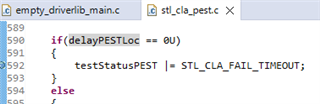

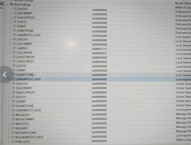

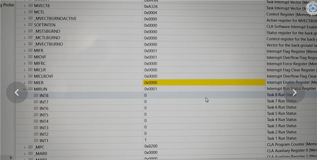

Hi experts,
I ask this for my question.
Now they have integrated CLA_STL into their application, and STL_CLA_testRegisters1(), STL_CLA_testRegisters2(), STL_CLA_testRegisters3(), STL_CLA_runPOSTMicro(), STL_CLA_runPESTMicro() pass, but the STL_CLA_ALL() failed, the returnVal is 1; I checked their cmd:

  • Hi Whitney
    We change the time to 100, but it still return timeout fault.
    We also check the register in MEM_CFG_REG, such as DxLOCK, all the value is 0.
    Is any other thing we need to check?
    BRs
    Shuqing
  • Can they place a couple breakpoints to try figure out which type of timeout they're seeing? Can they put one in stl_cla_pest.c and one in stl_cla_s.asm?
    stl_cla_pest.c in STL_CLA_runPESTMicro():
    stl_cla_s.asm in STL_CLA_runTest():
    Whitney
  • Hi Whitney,
    It return below result:
    Could you help to check if it any error in below register?
    BRs
    Shuqing
  • So if they put a breakpoint on line 591 it halts there? And MIRUN shows that task 1 is executing? That probably means the STL timed out waiting for Task 1 to finish, since it can't run until there are no active tasks. What is their task 1 doing? Does it take a long time to run?
    Whitney
  • Hi Whitney,
    Thanks for your suggestion, we find because of CLA TASK error configuration, the task will stuck in and then it will generate timeout error.
    In order to exclude the interference of these factors to let the task fail, they disabled task 2 to task 7 and just enable task 1 and task 8. What’s more, they also simplify the task 1 and task 8 that make sure TASK will finish in short time.
    After above modify, STL_CLA_runPESTMicro() will not return timeout at the very beginning of the test, and it will return 0x80 error in some test vector. And after running a period of time, it will return timeout.
    Could you give suggestion about the next steps?
    BRs
    Shuqing
  • Do they have interrupts enabled for some of their CLA tasks (i.e. what interrupts are enabled in PIEIER11)? Which bit in PIEIFR is set that is causing the value of 0x80 to be reported. Is it set before STL_CLA_runTest() is run or some time during?
    Whitney
  • Hi Whitney,
    We find the root cause: Customer use hardware trigger CLA TASK, and the time interval of trigger signal is too small, and it's in the microsecond range. So it is a possibility that when CPU execute the CLA STL, the trigger will generate again. Now if we increase the time interval of trigger, the CLA STL can pass successfully. Thanks for your help.
    BRs
    Shuqing
