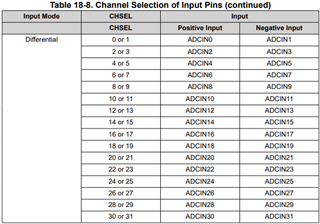

in the datasheet,ADC features as bellow:Differential signal conversions (16-bit mode only)• Single-ended signal conversions (12-bit mode only)• Input multiplexer with up to 16 channels (single-ended) or 8 channels (differential)
i want to know in differential mode,which channel is adcin-p and which is the adcin-n?what will happen if i congifure the adc as 16bit mode and single-ended?
    16-bit resolution is only supported for differential signal conversion. Regarding pin selection, you can refer to the following table in the TRM:
