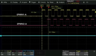

  • Hi Marlyn,
    Is that what you're saying?
        if(base!=EPWM1_BASE)
            EPWM_selectPeriodLoadEvent(base,EPWM_SHADOW_LOAD_MODE_SYNC);
        EPWM_setCounterCompareShadowLoadMode(base,
                                             EPWM_COUNTER_COMPARE_A,
                                             EPWM_COMP_LOAD_ON_SYNC_ONLY);
    The following waveforms are obtained, ch1-ch4 being EPWM1A-EPWM4A respectively.
  • Hi Zhen,
    Yes, something like what you have or the below. Does it change your output?
    EPWM_setCounterCompareShadowLoadMode(myEPWM0_BASE, EPWM_COUNTER_COMPARE_A, EPWM_COMP_LOAD_ON_CNTR_ZERO_PERIOD);
    In the scope capture you attached, why is EPWM1A low the entire time?
    Marlyn
  • Hi Marlyn,
    The problem with EPWM1A may be that I didn't connect the line properly, I see EPWM_selectPeriodDevent (myEPWM2_BASE/myEPWM3_BASE/myEPWM4_BASE, EPWM_SHADOW_LOAD_MODE_SYNC) is already in the routine.
    Then the original routine general EPWM_setCounterCompareShadowLoadMode (base, EPWM_COUNTER_COMPARE_A, EPWM_COMP_LOAD_ON_CNTR_ZERO); Adjusted for EPWM_setCounterCompareShadowLoadMode (base, EPWM_COUNTER_COMPARE_A, EPWM_COMP_LOAD_ON_CNTR_ZERO_PERIOD); But judging by the waveform, that doesn't seem to be the reason.
  • Hi Zhen,
    Thank you for sharing the corrected screen-shot. Looks like a sync event is only issued on the rising edge of the TBCTR=0 signal.
    Can you please start TBCTR during initialization at a value slightly under TBPRD so that when you start your EPWM CLK, the counter has a chance to pass 0 and issue a sync event?
    Marlyn

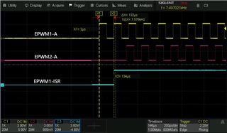

    Before enabling TBCLK=1, I set TBCTR of EMWM1 to 1900 and got the following waveform. I am not sure if this is what you said?
    In addition, I have done several tests. First, I set the level of GPIO to 1 in EPWM1-ISR, and the following waveform is obtained. However, from the waveform, it can be seen that the first TBCTR=0 is not entered into ISR, but the second TBCTR=0.The waveform does agree with the actual test results, which generate interrupts and syncouts when TBCTR = 0. But why is interrupt and SYNCOUT generated only when TBCTR is 0 for the second time?
    In addition, I made some Settings in IDLE loop of the program, when EPWM2-TBCTR>0, set GPIO to 1, and read that EWMP2-TBCTR is 376, EWPM2-TBPRD is 2000, and EPWM2-CMPA is 1000. From here, it seems that EPWM-TBCTR started counting and did not produce a corresponding action when equal to CMPA.
  • Hi Zhen,
    Thank you for doing additional tests and sharing the results. Have you modified the phase shift values from what is shown in the example?
    Let me replicate this issue on my setup. As I previously suggested, the EPWM could be looking for a transition edge of when TBCTR=0 for it to take the corresponding actions. I will need to discuss with some colleagues if this is case and what is happening here. I will get back to you as soon as possible.
    Marlyn

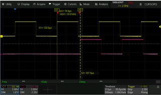

  • Hi Marlyn,
    This is the waveform obtained after TBPHS is set to 0 and TBCTR is set to 0. It can be seen that in the first pulse, EPWM2-A meets the condition of HIGH when ZERO, but does not generate LOW when CMPA. Again consistent with the previous test, for EPWM2, TBCTR goes from 0 to TBPRD at the beginning of the second pulse.
  • Hi Zhen,
    Thank you for sharing. What value of TBPHS did you have previously for EPWM2?
    Marlyn
  • Hi Marlyn,
    TBPHS is the value set in the routine. For EPWM2, it is 300.
  • Hi Zhen,
    Thank you, I wanted to make sure you had not modified this for debug purposes as I replicate this issue on my end. I will replicate this and get back to you as soon as possible.
    Marlyn
  • Hi Zhen,
    I have replicated the same behavior on my side and working to see if there is a workaround for this. I will keep you updated with my findings.
    Marlyn
  • Hi Zhen,
    Apologies for not being fully clear, earlier when I had suggested to change TBCTR to something slightly below TBPRD I meant for all EPWM instances not just EPWM1. If you make this change (Ex. TBCTR=1900 during initialization) you will see that the first pulse for the EPWM instances are aligned when EPWM1 equals zero. The first pulse will have a smaller duty cycle because it will start at defined TBPHS value, but after that the subsequent pulses should be of desired duty cycle.
