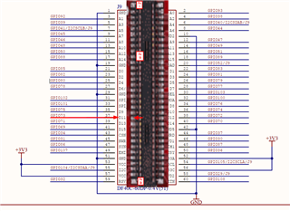

  • Hi Fleenor.
    Thanks for noticing the issue. Let me try this and I'll let you know.
    Btw, I'm attaching launchpad Schematic. Also, picture of board, where the J9 is also highlighted.
    LAUNCHXL-F28379D 开发套件 | TI.com.cn - Here also, you can see the board details.
    Shivani
    Schematic.zip
  • Hey Shivani,
    I thought this was a custom board and didn't realize you were using the Launchpad HW.
    GPIO73 does come out on the J9 header here on pin 37.
    Additional details on this header can be found here: https://www.digikey.com/en/products/detail/hirose-electric-co-ltd/DF40C-60DP-0-4V-51/1969488
    The most important point to note is the 0.016" (0.40mm) pitch.
    If possible, you can solder on a small >=26 AWG jumper wire to the pcb pad footprint of pin 37 which could then be (very carefully) probed for the XCLKOUT signal after making the changes mentioned previously.
    There are many excellent tutorials on YouTube and other channels demonstrating this kind of PCB modification (See PCB Modification by Soldering SMT Jumpers).
    If it is possible to directly probe the GPIO73-XCLKOUT signal, then any XBAR configuration requirements become a moot point.
    Let us know your thoughts and if you are able to correctly observe XCLKOUT with the provided solution.
    Zackary Fleenor
