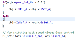

    2. As I mentioned earlier, we are able to run the motor in Torque control mode (running with encoder feedback) but we are unable to control the maximum speed of the motor.
    I am limiting maximum motor frequency in user_mtr1.h (USER_MOTOR1_FREQ_MAX_Hz) but as I increased obj->IsSet_A current, motor speed is increasing more than mentioned speed limit.
    After setting obj->IsSet_A  values again we are entering speed loop as per the UMCL but here, in this PI_setUi function we are not using any speed related variables to control or limit the speed. Can I know, why we are not able to limit motor speed here.
    Can I know, why we are only using these speed related variables in speed control loop but not in torque (current) loop.
    The maximum speed is limited to the motor and the adding load. You can't control or limit the maximum speed. If you want, you have to add a speed loop.
    Yes, only for speed loop as shown in the codes. No any reason, just control flow with different varaibles.
