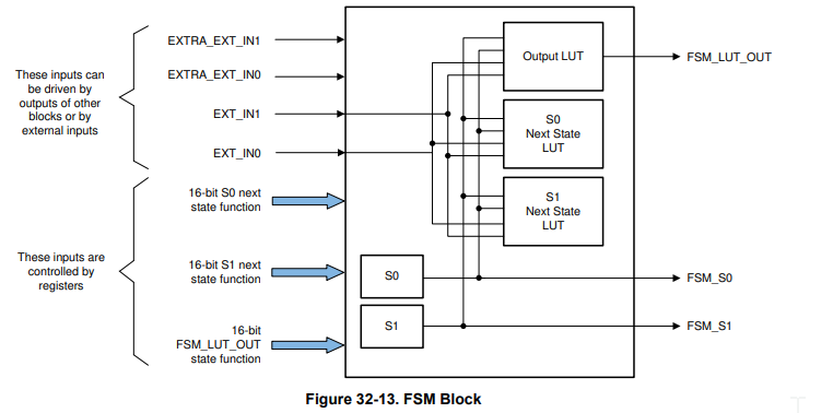

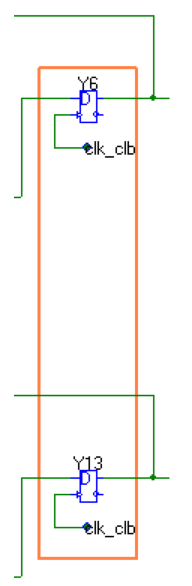

  • Hi Luke,
    Now I work with customer and realize RS latch with below configuration.
    Customers also want to know, what is the real logical structure of this configured latch? Which of the following is similar? This is related to the key verification of the customer's design, please be sure to help confirm, thank you!
     (without clock)
     (with clock)

  • Hi Julia,
    Apologies for the delayed response.
    This diagram in the TRM outlines the functionality of the FSM:
    A look up table is used for each state bit using s0, s1, e0, and e1 as inputs. On each CLB Tile clock edge, the current s0 and s1 values are updated based on the output of the lookup table.
    Let me know if this answers your question on knowing the logical structure of the FSM.
