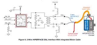

My current project need to use F28388D to support Endat2.2, Hiperface DSL and quadrature encoders. Right now I'm using FPGA and SDRAM for HDSL and EnDat IP core but I would like to get rid of the FPGA. I found some documents shows how to implement EnDat2.2 with CLB and SPI on Delfino processors. I'm thinking if it support Hiperface DSL as well? Or the FPGA is necessary just for applying HDSL with F28388D?

    Could you provide some basic block diagram or description of the HDSL functionality? I am not familiar with this protocol.
    Note the CLB resources are very limited (only 3 counters, 3 FSMs, etc.), so it cannot achieve the same flexibility as a real FPGA.

    I found this document from TI about an encoder interface design for C2000 MCU and AM437X: https://www.ti.com/lit/pdf/tiduan5
    It has the figures for Hiperface DSL interface on page 8, hope it can explain the usage of this protocol:
    This design support HDSL, but seems only for AM437x but not for C2000MCU. Could you confirm that with me?

  • Hi Jing,
    In the product description it says TIDA-00179 is used, which uses either AM437x or F2837x. If F2837x support this I think F2838x should as well.
    I am struggling to find a detailed digital circuit that represents the HDSL protocol. Would you be able to extract this from your FPGA design? I'm looking for a diagram that includes AND/OR/NOT gates, shift registers, etc. to show the exact behavior desired.

  • Hi Luke,
    Unfortunately the FPGA design I used doesn't include the detailed logic for HDSL protocol. The HDSL protocol is represented by the IP core provided by SICK, and I only built the interface to the IP core in FPGA.

  • Hi, I will move my question regarding the AM437x to other forum, but I still would like to get the answer about F28388D:does it support the HDSL signal decoding?
    For example, as the TIDA-00179 encoder interface board claims it provides direct interface to the host processor like Delfino F28379, but I can't figure out how to interface the HDSL signal to the processor and how to process the HDSL encoder data. Any advice or reference documents?

  • I still would like to get the answer about F28388D:does it support the HDSL signal decoding?
    Hi Jing,
    No, We do not support HDSL on C28x devices. The AM263 supports HDSL.
