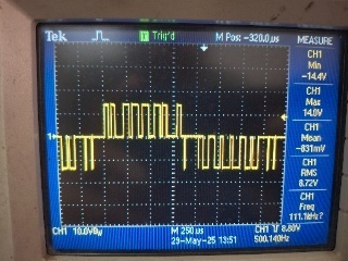

I'm working on a 3-phase SPWM generation system on a TMS320F28335 DSP using a 12-bit sine lookup table (4096 points).
My goal is to generate a symmetrical sine-triangle PWM waveform.
The system works to an extent, but I’m facing asymmetry issues in the output pulses:
  • For example, when I probe the output waveform, I get 8 pulses on the positive side and 10 pulses on the negative side of the sine wave when I set fundametal 500Hz and Switching 4500Hz.
  • It shall be 9/9.
I am attaching my main file with this thread.
Would greatly appreciate your insights!

__interrupt void epwm1_isr(void)
    // Calculate indices for three phases (0°, 120°, 240°)
	Uint32 index_u = ((Uint32)phase_acc) % TABLE_SIZE;
	Uint32 index_v = (index_u + TABLE_SIZE / 3) % TABLE_SIZE;
	Uint32 index_w = (index_u + 2 * TABLE_SIZE / 3) % TABLE_SIZE;
	phase_acc += phase_step;
	if (phase_acc >= TABLE_SIZE)
	    phase_acc -= TABLE_SIZE;
    // Get sine values from table
    float sine_u = sine_table[index_u];
    float sine_v = sine_table[index_v];
    float sine_w = sine_table[index_w];
    // Scale by modulation index and convert to timer counts
    Uint16 duty_u = (Uint16)((pwm_period/2) * (1.0f + modulation_index * sine_u));
    Uint16 duty_v = (Uint16)((pwm_period/2) * (1.0f + modulation_index * sine_v));
    Uint16 duty_w = (Uint16)((pwm_period/2) * (1.0f + modulation_index * sine_w));
    // Update compare registers
    EPwm1Regs.CMPA.half.CMPA = duty_u;
    EPwm1Regs.CMPB = duty_u;
    EPwm2Regs.CMPA.half.CMPA = duty_v;
    EPwm2Regs.CMPB = duty_v;
    EPwm3Regs.CMPA.half.CMPA = duty_w;
    EPwm3Regs.CMPB = duty_w;
    // Clear interrupt flag
    EPwm1Regs.ETCLR.bit.INT = 1;
    PieCtrlRegs.PIEACK.all = PIEACK_GROUP3;
