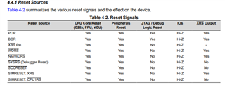

    1. By ON/OFF testing of the device, which of the resets did you do?
    1. When you see the "issue where LIN communication fails to operate", does this mean there will never be a response on the LIN bus until the next reset? Or it just takes some time after starting up to begin working?

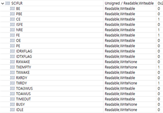

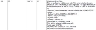

    As observed, LIN communication is functioning normally, but the error flags CE (Checksum Error) and FE (Framing Error) are not being cleared. It is said that they are cleared upon reception of a new sync break, but I would like to understand why they are not cleared even when a valid LIN frame is received.
    These flags should be automatically cleared if the next synch break is received successfully. Note however that they will be set again if the next packet has errors. How are you checking the status of the flags? Are you stopping at a breakpoint inside a LIN ISR? Do you have continuous refresh toggled on?
    Delaney
  • I checked the register flag values through the debugger connection.
    Even when the Sync Break is transmitted, the flags are not cleared.
    Additionally, I did not pause execution using a breakpoint.
    Continuous refresh is enabled.

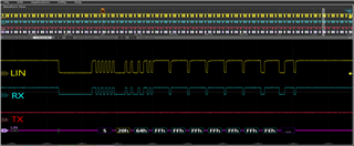

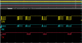

    As shown in the waveform below, there is no noise or data corruption — the frame comes in perfectly normal.
    However, the LIN frame error does not get cleared.
    To prevent receiving abnormal values due to noise, we check the LIN error flag before accepting data.
    However, even when a valid frame is received, the error flag does not get cleared.
    For the framing error specifically, this indicates that synchronization of packets between the transmitting LIN and the receiving LIN has been lost. If this is the case, the framing error flag will continue to get raised since it is always looking at the wrong portion of each frame (maybe it is shifted by one bit). For this reason, even if the data looks fine after the error takes place, it can detect a framing error. This issue would also cause a checksum error since the module would be computing the checksum on the wrong part of the message and comparing to the wrong byte.
    Usually, with these types of errors, it is best to avoid them all together by fixing the software implementation rather than trying to recover the module from this state.
    What baud rate and SYSCLK frequency are you using? - This will help determine if the configurations are prone to errors.

    1. TX transmits data normally. If bits are corrupted or the timing is off, does this kind of issue only occur on the RX (receiver) side?
    2. If bits are corrupted or the timing is off, shouldn't LIN communication still fail even if the error flag is manually cleared (set)?
    3. To identify the root cause in detail, what should I check specifically? Can you point out the key areas to focus on?

  • When clearing the LIN error flags (BE, CE, FE, OE) in the SCIFLR register, I’m considering two methods: setting the SWnRESET bit (SCIGCR1.7) or writing a 1 directly to the flag bit. In the case of setting the SWnRESET bit (SCIGCR1.7), are there any side effects?
    Delaney is still out of office the next week. I will try to provide some information in the meantime.
    Regarding the two methods:
    1. Using SWnRESET (SCIGCR1.7):
    • Keep in mind this SW RESET ensures all flags in SCIFLR register are frozen with their reset values while SWnRST = 0. This means the SW RESET affects multiple flags and LIN functionality (state machine is reset), not just error flags. This can be a benefit when needed to recover communication after error handling, but just be aware that not only one error flag is reset.
    2. Writing 1 directly to error flags:
    • This is a more targeted approach as it only affects the specific error flag being cleared. This ensures your other configurations are not reset as noted above. However, depending on your system error, simply clearing the single flag may not be enough to restore LIN functionality. In that case, RESET would be advised.
