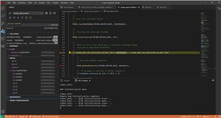

  • Hello Joseph,
                        Thanks for the reply.and providing information.
    I am able to set the proper baudrate now . But iam not getting the receive interrupt. i am here by attaching code and debug snapshot.
    Line 365 breakpoint not hit as there is no new data. but data iam sending from another node, the Rx interrupt unable to recognize by F280039C.

  • Hello Joseph,
                          I have inserted the code. Thank you.
    1.Clock set properly  120Mhz /3 (the corresponding SYSCTL_MCANCLK_DIV_4 = 3U used.
    2.Baudrate at the Aurix side 2Mbps already working fine.F280039C also set 2Mbps.
    3.As iam not receiving the CAN Rx interrupt i suspect whether line 188 causing any issue as  MCAN_INTR_MASK_ALL is used.
    4.I have attached screenshot of ACK group interrupt getting cleared after serving interrupt.
    If interrupt occurred in code means then why data not received as iam getting CANRx error.

    mcan_ex4_receive example uses standard ID (11-bit length) and is expecting a message ID of 4.  Check that this is the message ID configuration that is set by the transmitting node.  It seems like code is entering the ISR routine but it is not receiving the correct ID hence message frame is not read out.
    Here is that portion of the message ID configuration:
        // Initialize Message RAM Sections Configuration Parameters
        msgRAMConfigParams.flssa                = MCAN_STD_ID_FILT_START_ADDR;
        // Standard ID Filter List Start Address.
        msgRAMConfigParams.lss                  = MCAN_STD_ID_FILTER_NUM;
        // List Size: Standard ID.
        msgRAMConfigParams.rxBufStartAddr       = MCAN_RX_BUFF_START_ADDR;
        // Rx Buffer Start Address.
        msgRAMConfigParams.rxBufElemSize        = MCAN_RX_BUFF_ELEM_SIZE;
        // Rx Buffer Element Size.
        // Initialize Rx Buffer Configuration parameters.
        stdFiltelem.sfid2              = 0x0U; // Standard Filter ID 2.
        // Configuring received frame to be stored in buffer element 0
        stdFiltelem.sfid1              = 0x4U; // Standard Filter ID 1.
        // Confifuring frames with msg ID = 0x4U to be accepted by filter element
        stdFiltelem.sfec               = 0x7U; // Store into Rx Buffer
                                               // configuration of SFT[1:0] ignored
    In the ISR, this should be the branch that the code is executing if the correct message ID is received:
        //  Check to see if the interrupt is caused by a message being
        //  received in dedicated RX Buffers
        if((MCAN_INTR_SRC_DEDICATED_RX_BUFF_MSG & intrStatus) == MCAN_INTR_SRC_DEDICATED_RX_BUFF_MSG)
            // Read the NewData registers
            MCAN_getNewDataStatus(MCANA_DRIVER_BASE, &newData);
            //  If message is received in buffer element 0
            if((newData.statusLow & (1UL << 0U)) != 0)
                MCAN_readMsgRam(MCANA_DRIVER_BASE, MCAN_MEM_TYPE_BUF, 0U,
                              0, &rxMsg1);
                rxMsg[loopCnt] = rxMsg1;
            //  Clearing the NewData registers
            MCAN_clearNewDataStatus(MCANA_DRIVER_BASE, &newData);
        else
    Joseph
