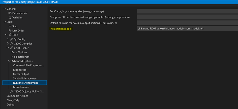

I have used bit fields in my program on the F29H85x CPU2. When configure to flash build, the following warning is thrown. How can I resolve this issue?

Hi Shashank,
Any reason you are using the RAM autoinitialization model, instead of ROM model?

Samritha,
I am used bit fields to initialize the Cpu Timer0 in CPU2, changed to ROM model, which making Cpu2 execute autoinit.h how to resolve this issue.
Can you share which example you are seeing the default to be ram_model if it is from our F29H85x-SDK.
Are you creating a single .out file, like in the SDK?

Samritha,
This is the multi-core empty project(not from SDK).
It is creating cpu1 .out which includes cpu2 .out and cpu3 .out file.
in Flash Build Configuration it is deleting cpu3 .out file
I am used bit fields to program Pipe, timer, EPWM and adc modules
Which are highlighted in generated warning.
Project run time environment is in - RAM model.
Cpu2 is executing functions in autoinit.h file. What it means, and how to resolve this issue?

Do let us know the scenarios in which you are facing the issue. I could not reproduce it for now.
Please go through this page to know more about the Initialization models. 6.3. Run-Time Initialization — C29 Clang Compiler Tools User's Guide
