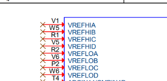

    Even though you want to poll vs INT, I would still look at the initADC() function in the adc_ex3_temp_sensor pjt. Looking at your code above it appears that you are missing this function call
    ADC_setMode(ADCA_BASE, ADC_RESOLUTION_12BIT, ADC_MODE_SINGLE_ENDED);
    Since you are getting 4095, I suspect that the ADC reference is not on, which would make any conversion look like FSR = 4095.  Try to add the above function call, if that doesn't work, I would recommend stepping through that example to see if there is another function that is missing.
    Matthew
  • hi matthew,
    when used the temperature example code on EVM board of TMS320f28377D it is working fine but if i used on my custom board the values are not coming can u please help me out

     TI example code is working on EVM board (evaluation board) but on our custom made PCB with TMS320f28377D microcontroller is not working am continuously getting 4095(in decimal) as output of ADC_readResult function
    regards
    J.Muniniteesh
  • Muniniteesh,
    Thanks for the update.  Can you comment on what is connected to the VREFHI/VREFLO pins(please see below from the DS)?
    We are expecting an exteranal precision reference to drive these pins.  If these are floating or grounded it may explain why you are seeing 4095 all the time.
    Matthew
  • Matthew,
    thanks for your reply. in our design we did not connected any source to drive those pins that is the reason why am getting 4095
    regards
    J.Muniniteesh
