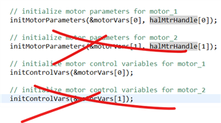

I am using LAUNCHXL-F28P55X with BOOSTXL-3PHGANINV and the project dual_axis_servo_drive_fcl_qep_f28p55x
In "dual_axis_servo_drive.c" declaring "motorVars[0]" and "motorVars[1]" the two motors are initialised:
I only have one motor, so I want to deactivate all the code concerning the second one.
Is it enough for me to comment on the second function?
Is there anything else I need to do?
..I don't want to waste resources by running portions of code in the background for an motor that I don't use

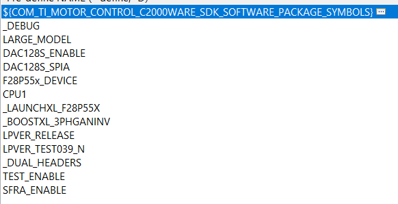

I also have another question:
Here I have to activate/deactivate something?
I see for instance a '_' before BOOSTXL-3PHGANINV, should it be removed?
    To relieve all device resources I believe you'll need to make changes to the structs / handles used for the 2nd motor, so it's a little more involved. Removing the function calls is needed as well of course.
    Like changing below from a size 2 array to just a single struct (non-array) for single motor usage.
    HAL_MTR_Handle halMtrHandle[2];   //!< the handle for the hardware abstraction
                                      //!< layer to motor control
    HAL_MTR_Obj    halMtr[2];         //!< the hardware abstraction layer object
                                      //!< to motor control
    I don't see it used in the project, can do ctrl-h search for it to check.

  • Thank you for your reply.
    So you mean:
    HAL_MTR_Handle halMtrHandle[1];   //!< the handle for the hardware abstraction
    HAL_MTR_Obj    halMtr[1];         //!< the hardware abstraction layer object
    And then remove functions like these:
    1) After all this, is there then a method/variable that indicates that motor two has been deactivated?
    2) In your opinion, does it make sense to do all this if I only want to use one motor? ..maybe the resources used by cpu, pwm etc. to drive the second motor (which isn't there) are derisory/insignificant ..however, consider that the driver and the engine will have to run for 8 hours
    Yes, that's what I meant but you technically don't need the [1] since it's no longer an array. If you build the project after making that change I think it should give errors which can indicate where you need to make changes.
    It depends on your application & needs. I think removing the unused things is good in case you need to add additional features.
    Kevin
