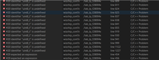

I got Errors that say identifier int8_t is udentified. Anyone knows what to do?
    Please note that this C2000 device is 16-bit addressable. Do you have stdint.h included in your project C files? Are you using the type defs native to the CPU?
    Allison
  • Yes, i do have stdint.h included in all of the c files. I am also using files dedicated to wiz5500io connection (Application.h, wizchip_conf.h, wzichip_conf.c, socket.c, socket.h, w5500.c, w5500.h) downloaded from GitHub as a ioLibrary_Driver-master folder. In the wizchip_conf.h, socket.c and socket.h i have a problem mentioned in the description. I tried using an include option in properties of a project and adding stdint.h in the mentioned C files but it wasn't working.
    Thanks for following up. Let me review this information and get back to you today.
    Allison
    To clarify, please make sure that the include path to stdint.h is properly set in your project properties. You need to verify that the compiler can find the correct stdint.h file. Also, is the stdint.h included before the WizNet W5500 library files? If not, try reorganizing your includes to ensure stdint.h is included first at the top of your files.
    Other ideas: can you check if there are any conflicting type definitions in other header files that might be interfering with the stdint.h definitions. And what compiler version are you using?
    Allison

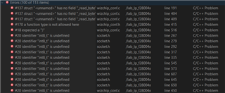

  • I am using TI v22.6.1.LTS compiler version. I had included stdint.h as first at the top of every file, i also checked if the include path to stdint.h is correct and it all seemed fine. There is no any conflicting type definitions. I have no idea what else i can do to get rid of the type definition problem.
    Can you try to 'ctrl' + 'click' on the int8_t and see the location it takes you? Can you send a snippet of the specific error you are seeing?
    Allison
  • After clicking 'ctrl' + 'click' it took me to the file called "hw_types.h". Error: #20 identifier "int8_t" is undefined, #20 identifier "uint8_t" is undefined.
    Can you please send a screen capture of the exact error you are seeing? Are you able to share the relevant code?

    Thanks for sending these. Please allow another day for me to take a look.
    Allison
    Following up as I am still taking time to look into this. I appreciate your continued patience.
    Allison
    Thanks for your continued patience as I haven't been able to recreate your exact setup with only these files. Is there any update on your end?
    • To reiterate, this device uses 16-bit addressing and does not inherently support 8-bit data types. Is there a reason you are trying to use 8-bit when this is not supported in the underlying architecture? It would be recommended to use 16-bit words as these are the native data types.
    • Please be sure to include correct header files:
      • #include <stdint.h>
        #include <stdio.h>
        #include <string.h>
        #include <stdlib.h>
    • Additionally, please make sure your include paths are properly set up in CCS (see project properties), check that you're using the latest version of C2000Ware for your development, and verify that all necessary device support files are included in your project.
    Allison
  • Hi. Thanks for your answer. I have tried doing what you suggested and now i got this error. Do you know what i can do with this? ...

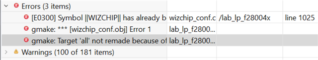

  • Hi
    I have listened to your advises and i replaced uint8_t with uint16_t, after that there were a lot of unnamed variables so i named them and after that this 3 errors showed up.
    lab_lp_f28004x (2).zip
    I will check into your project. Just to ensure we are on the same page, can you please send a snippet showing exactly which 3 errors you are seeing?
    Allison
    I confirm I see the same errors, so I'm checking some of the include paths. There are also many warnings that need to be addressed. I'm taking a look at those as well and will update in the next day.
    Appreciate the patience!
    Allison
    Thanks for the patience. I've taken a deeper look at your WizNet Ethernet controller project. There are several issues I saw preventing it from compiling. Keep in mind I don't have the same setup as you - mine had more issues showing due to having different paths etc.:
    1. Multiple variable definition:
      1. The main error is that the variable WIZCHIP is defined more than once in your code. Having two variables defined with the same name confuses the compiler as to which one you're referring to.
      2. You need to find where WIZCHIP is defined in wizchip_conf.c and make sure all other files only declare it with extern _WIZCHIP WIZCHIP.
    2. Missing folder paths
      1. I have different folder paths than you, so yours may look okay (e.g. I had 305 warnings whereas you had 181). When I imported, the project was looking for files in folders that don't exist on my computer and caused issues for me. It would be best you review your project settings in case they are trying to point to any incorrect or nonexistent directories.
    3. Bit shifting issues
      1. This MCU uses 16-bit integers, but your code tries to shift bits beyond 16 positions many times.
      2. You need to fix any operations that try to shift beyond the defined variable length you defined (e.g. shifting <<24 when it's only 16-bit).
    4. Code structure issues
      1. Some parts of your code can never be reached (unreachable statements), structures are initialized with the wrong number of values, there is mixing of string data with numeric arrays without proper conversion, functions are used before their declaration.
      2. In wizchip_conf.c, you should remove the duplicate return statements, update the WIZCHIP initialization to include all required fields, add values for all required fields when initializing the WIZCHIP structure, and add proper function declarations before using them.
    The most critical fix is the multiple definition of WIZCHIP, as this prevents compilation entirely. The other issues are important to fix but would only appear after resolving this main error. I unfortunately cannot offer more guidance since I don't have have familiarity with the WizNet libraries/software support. I can only offer support on C2000 SW.
    Allison
