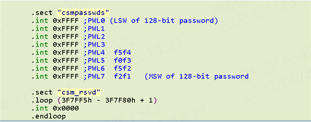

TMS320F28069: The chip can work normally when debugging with the XDS100V2 emulator, but it malfunctions when powered solely by the emulator.
Part Number: TMS320F28069
The chip functions properly when debugged using the XDS100V2 emulator. The LCD control function within the RTOS task executes successfully, but the LCD exhibits flickering.When the XDS100V2 emulator is used for power supply without debugging, the LCD light control function in the RTOS task fails to run, and the LCD light does not light up.
Here's my CMD code::.

MEMORY
PAGE 0 :   /* Program Memory */
           /* Memory (RAM/FLASH/OTP) blocks can be moved to PAGE1 for data allocation */
   RAMM1       : origin = 0x000400, length = 0x000400     /* on-chip RAM block M1 */
   RAML3       : origin = 0x009000, length = 0x001000
   RAML45      : origin = 0x00A000, length = 0x003000
   /*RAML0       : origin = 0x008000, length = 0x000800     on-chip RAM block L0 */
   /*RAML1       : origin = 0x008800, length = 0x000400     on-chip RAM block L1 */
   /*RAML2       : origin = 0x008C00, length = 0x000400     on-chip RAM block L2 */
   /*RAML3       : origin = 0x009000, length = 0x001000     on-chip RAM block L2 */
   /*RAML4       : origin = 0x00A000, length = 0x002000     on-chip RAM block L4 */
   OTP         : origin = 0x3D7800, length = 0x000400     /* on-chip OTP */
   /*FLASHH      : origin = 0x3D8000, length = 0x004000     on-chip FLASH */
   /*FLASHG      : origin = 0x3DC000, length = 0x004000     on-chip FLASH */
   /*FLASHF      : origin = 0x3E0000, length = 0x004000     on-chip FLASH */
  /* FLASHEND    : origin = 0x3E4000, length = 0x000100*/
  /* FLASHEND    : origin = 0x3E4000, length = 0x000020*/
   /*FLASHTYPE   : origin = 0x3E4020, length = 0x0000E0*/
   FLASHJClr1  : origin = 0x3D8100, length = 0x000100
   FLASHJClr2  : origin = 0x3D8200, length = 0x000100
   FLASHBCDEFG  : origin = 0x3D8348, length = 0x01BCB4     /* on-chip FLASH */
   DSPVISION  : origin = 0x3D8300, length =  0x4
   GOTOMAIN    : origin = 0x3D8304, length = 0x4     /* on-chip FLASH */
   FLASHEND    : origin = 0x3D8308, length = 0x000020
   FLASHTYPE   : origin = 0x3D8328, length = 0x000020
   /*FLASHSTART  : origin = 0x3F3FFF, length = 0x01*/
   DSP_BOOT  : origin = 0x3F5000, length = 0x04     /* on-chip FLASH */
   FLASHA      : origin = 0x3F5004, length = 0x002F78     /* on-chip FLASH */
   FLASH_BOOT  : origin = 0x3F3FFC, length =  0x4		/* on-chip FLASH */
   CSM_RSVD    : origin = 0x3F7F80, length = 0x000076     /* Part of FLASHA.  Program with all 0x0000 when CSM is in use. */
   BEGIN       : origin = 0x3F7FF6, length = 0x000002     /* Part of FLASHA.  Used for "boot to Flash" bootloader mode. */
   CSM_PWL_P0  : origin = 0x3F7FF8, length = 0x000008     /* Part of FLASHA.  CSM password locations in FLASHA */
   FPUTABLES   : origin = 0x3FD860, length = 0x0006A0	  /* FPU Tables in Boot ROM */
   IQTABLES    : origin = 0x3FDF00, length = 0x000B50     /* IQ Math Tables in Boot ROM */
   IQTABLES2   : origin = 0x3FEA50, length = 0x00008C     /* IQ Math Tables in Boot ROM */
   IQTABLES3   : origin = 0x3FEADC, length = 0x0000AA	  /* IQ Math Tables in Boot ROM */
   ROM         : origin = 0x3FF3B0, length = 0x000C10     /* Boot ROM */
   RESET       : origin = 0x3FFFC0, length = 0x000002     /* part of boot ROM  */
   VECTORS     : origin = 0x3FFFC2, length = 0x00003E     /* part of boot ROM  */

SECTIONS
   /* Allocate program areas: */
   .cinit              : > FLASHBCDEFG,     PAGE = 0
   .pinit              : > FLASHBCDEFG,     PAGE = 0
   .text               : > FLASHBCDEFG,     PAGE = 0
   codestart           : > BEGIN,        PAGE = 0
   .textJMP1           : > FLASHJClr1    PAGE = 0
   .textJMP2           : > FLASHJClr2    PAGE = 0
   codeupdate          : > FLASHA,   PAGE = 0		/* Added by Leon on Nov. 17, 2006 */
   dspboot            : > DSP_BOOT,    PAGE = 0
   GotoMain         : > GOTOMAIN,     PAGE = 0
   BOOTFLAG         : > FLASH_BOOT,  PAGE = 0 //
    DSPVision         : > DSPVISION,  PAGE = 0
   /*FlashStart          : > FLASHSTART    PAGE = 0*/		/* Added by Leon on Nov. 17, 2006 */
   FlashEnd            : > FLASHEND      PAGE = 0
   FlashType           : > FLASHTYPE     PAGE = 0       /* added for Special flash flag for Main DSP */
   BootRamfuncs        : LOAD = FLASHA,
                         RUN = RAMM1,
                         LOAD_START(_Flash28_API_LoadStart),
                         LOAD_END(_Flash28_API_LoadEnd),
                         RUN_START(_Flash28_API_RunStart),
                         PAGE = 0
    GROUP
       ModuleCodeLib_RAM
       ramfuncs
                         LOAD = FLASHBCDEFG,
                         RUN = RAML45,
                         LOAD_START(_RamfuncsLoadStart),
                         LOAD_SIZE(_RamfuncsLoadSize),
                         RUN_START(_RamfuncsRunStart),
                         PAGE = 0
   csmpasswds          : > CSM_PWL_P0, PAGE = 0

The abovementioned issue occurs after adding the following code.
#pragma CODE_SECTION(ZeroCrossingInterrupt,"ramfuncs");
interrupt void ZeroCrossingInterrupt(void)
	Uint32 dwZeroTemp;
	dwZeroTemp = ECap1Regs.CAP1;
	udwOPFrecyIntr = dwZeroTemp  - udwLineZeroCrossingOld;
	if(1 == ECap1Regs.ECFLG.bit.CEVT1)
		udwLineZeroCrossingOld = dwZeroTemp;
	ECap1Regs.ECCLR.bit.CTROVF = 1;
	ECap1Regs.ECCLR.bit.INT = 1;
	ECap1Regs.ECCLR.bit.CEVT1 = 1;
	ECap1Regs.ECCTL2.bit.REARM = 1;
	PieCtrlRegs.PIEACK.all = PIEACK_GROUP4;
