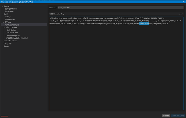

    Let me answer your Qs in order as well.
    1. “identifier ‘int32’ is undefined”:
    Compiler macro is one way to do it, but it's a little bit hacky and needs to be ported from one project to another, can you define `typedef int32_t int32;` instead? (you can include stdint.h if int32_t isn't already defined).
    2. TI-COFF vs EABI:
    In the newer generation devices we have promoted EABI as the default abi, though TI-COFF is still supported. Looks like the Solar_Lib_IQ.lib is generated using TI-COFF format and therefore caused the incompatibility.
    In CCS20, can you right click the project and go into Properties->Tools-> C2000 Compiler and change the --abi= from eabi to coffabi?
    For future purposes though, I do recommend re-generating the .lib libarary in EABI. If you have the source code, you easily open another CCS (library) project and generate a new lib using EABI.
