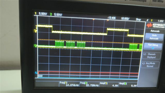

  • I have set the SPI clock frequency to 1 MHz, and I have verified it on the oscilloscope—it is correct.
    However, I am unable to read any default register values; the data always shows as 00.
    Now, what hardware-related things should I check in this case?
    Also, please verify whether my SPI settings in the code are correct for the ADS1258
    specifically, the CPOL and CPHA (Clock Polarity and Phase) bits.
     Can you check whether I’ve made any mistake in my code related to SPI settings?

  • Based on the ADS1258 timing diagram on the device datasheet page 7, there is a delay of t_dist between the data pin bit being asserted and the first rising edge of the clock, which is when the sampling is expected. Based on the F2837xD device TRM page 2263 SPICLK option descriptions, this should correspond to a rising-edge-with-delay configuration, or POL=0, PHASE=1.
    It looks like this isn't the configuration you're using. If you fix this, does it solve the issue?
    Jason Osborn
  • s a basic test, I'm trying to read the default value of the CONFIG0 register (address 0x00), which according to the datasheet should return 0x0A. However, I'm consistently receiving 0x0040 in the RXBUF. I've configured the SPI with CLKPOL = 0 and CLKPHA = 1 based on the ADS1258 datasheet timing diagram (page 7) and the F2837xD TRM guidance regarding tDIST, which suggests data should be sampled on the rising edge with a delay. The reset and power-up sequence I'm using is as follows: first, I set START high, then drive PWDN low → delay → high, followed by RESET low → delay → high. I verified this sequence using an oscilloscope. I’m sending 0x40 (RREG command for register 0x00) via SPI, and the waveform matches what I expect: yellow is SCLK and green is MOSI showing 0x40, though it seems to align on the falling edge. Despite trying various delays and pin sequences, I'm still not receiving the expected 0x0A. Is there an issue with the timing, CS handling, or does ADS1258 require a specific delay after RESET before communication? Any insights on what might be going wrong would be appreciated.

  • Depending on how you're clocking the device, the ADS1258 clock is not valid for a certain amount of time after RESET is asserted. Wake-up time is described on page 24 of the device datasheet.
    To be clear- are you using the PWDN or RESET pin? The RESET pin clears registers to their default state, but PWDN explicitly does not do this.

  • My current task is to read the default value of the CONFIG0 register (which should be 0x0A) from the ADS1258 ADC using a TMS320F28379D microcontroller.
    I have attached my code below.
    In the first oscilloscope image:
    • Yellow shows the /CS (chip select) line, which goes from high to low.
    • Green is the SCLK line, which is set to 1 MHz.
    In the second image:
    • Yellow shows the MOSI line, where the data 0x40, 0x00, 0x00 is being transmitted (to read CONFIG0).
    • Green again shows the SCLK.
    The problem is:
    • I'm not getting any response on the DOUT (MISO) line.
    • Nothing is read into the register variable in my code.
    However, when I use the ADS1258EVM software, I'm able to read the register values correctly without issue.
    Any suggestions would be appreciated — especially if there's something I might be missing in the SPI setup, timing, or ADS1258 configuration/reset sequence.

     As per your suggestion I made changes in my code but still I cant read the data..
    I used the ADS1258EVM software and tried to read the CONFIG0 register. When I clicked the Read button, I captured the following images on the oscilloscope:
    1. On the DIN pin: the data sent is 0x40, 0x00 to read the CONFIG0 register (Yellow: MOSI, Green: SCLK)(see image_1)
    2. On the DOUT pin: the data read from the ADS1258 is 0x0A.(see image_2)
      And tell me one thing — finally, what should be the value of the CLKPOLARITY and CLK_PHASE bits?
  • In an earlier post, I stated that it looked to me like POL=0, PHASE=1 (rising edge with delay), based on the ADS1258 datasheet. Based on the waveforms provided, this still appears to be correct.
    None of the posts so far with your software have shown MISO/DOUT. Is anything showing up on MISO at all when you use it? If not, can you try other commands?
    As far as I can tell, the MOSI signal from your SW and the MOSI signal from the ADS1258EVM SW look the same. This makes me think that something else is going wrong.
    In your SW:
    • If you're not able to see any response on MISO from any commands, then I'm concerned that the board itself isn't properly powered-on, which is why I asked about the RESET pin earlier.
    • If you ARE able to see response on MISO, then we'll need to take another look at the SPI Rx implementation.
    Jason Osborn
  • I have attached the complete code that I am using. On the oscilloscope, I am not seeing any response on the MOSI pin — only blank data is visible. Please check and let me know what the issue might be.

  • I don't think the problem is related to the SPI, at this point. It seems more like a problem with the setup, like I suggested before. I believe your power-on process is not correct, particularly given you're seeing nothing on MISO.
    Please look at the following pins and compare the behavior of your code with the behavior of the ADS1258EVM GUI. Perform each of the following tests in order:
    1. ADC Clock (aka MCLK_OUT in the schematic)
    2. RESET
    3. PWDN
    4. SPI Clock and MOSI, setting your oscilloscope time scale to observe a single pulse on the MOSI pin.
    Corresponding debug activities:
    1. If you don't see anything on the ADC Clock (i.e. main system clock), then you need to set up a 16MHz clock source for the ADS1258.
      1. The simplest way to do this is to configure an unused ePWM at 16MHz and 50% duty cycle. See the ePWM examples and TRM section for details.
      2. If no ePWM signals are available in your end application, you can also use the APWM functionality of the eCAP peripheral or simply configure one of the CPU Timers to toggle a GPIO at the desired frequency.
    2. (see (3) )
    3. If RESET or PWDN is in an incorrect state, alter your configuration accordingly.
    4. If SPI Clock and DIN/MOSI relationship does not match, then I misinterpreted the SPI clock configuration due to the zoom level, apologies- set POL=0, PHASE=0.
    Jason Osborn
    So, I have now generated an external 16 MHz clock and given it to the ADC_CLK pin of the ADS1258.
    I checked the waveforms of RESET, PWDN, MOSI, MISO,SCLK and CS on the oscilloscope and compared them with the waveforms tested on the ADS1258 EVM-PDK board, and they are correct. SCLK freq is 1MHz.
    Now, I can see data on the MISO pin/DOUT on the oscilloscope, but it is not 0x0A as expected. I have attached the oscilloscope image as well as the code.
    Based on the waveform comparison, the Clock Polarity = 0 and Clock Phase = 1.

       InitPieCtrl();
    // Disable CPU __interrupts and clear all CPU __interrupt flags:
       IER = 0x0000;
       IFR = 0x0000;
    // Initialize the PIE vector table with pointers to the shell Interrupt
    // Service Routines (ISR).
    // This will populate the entire table, even if the __interrupt
    // is not used in this example.  This is useful for debug purposes.
    // The shell ISR routines are found in F2837xD_DefaultIsr.c.
    // This function is found in F2837xD_PieVect.c.
       InitPieVectTable();
        // Enable global Interrupts and higher priority real-time debug events:
        IER = M_INT1 |M_INT3 | M_INT8 ;                        // For ADCA0,EPWM1 and for SCIC_RX
        EPWM1_TIMER_TBPRD=2;  // Period register
        EPWM1_MAX_CMPA=1;
        EPWM1_MIN_CMPA=1;
        EALLOW;
        CpuSysRegs.PCLKCR0.bit.TBCLKSYNC = 0;
        EDIS;
        InitEPwm1Example();
        EALLOW;
        CpuSysRegs.PCLKCR0.bit.TBCLKSYNC = 1;
        EDIS;
        //worktime start
        PieCtrlRegs.PIEIER1.bit.INTx7 = 1;
    // Step 4. Initialize the Device Peripherals:
       spi_fifo_init();     // Initialize the SPI FIFO
    // Step 5. User specific code:
       adcStartupRoutine();
       for(;;)
           readSingleRegister(0x00);
           DELAY_US(10000);
    void adcStartupRoutine(void)
        /* (OPTIONAL) Provide additional delay time for power supply settling */
        DELAY_US(50000);
        /* (REQUIRED) Set nRESET/nPWDN pin high for ADC operation */
        GpioDataRegs.GPBCLEAR.bit.GPIO52 = 1;  // PWDN low
        DELAY_US(100);
        GpioDataRegs.GPBSET.bit.GPIO52 = 1;    // PWDN high
        DELAY_US(10000);
        /* (REQUIRED) tWAKE delay */
        DELAY_US(5000);
        /* (OPTIONAL) Toggle nRESET pin to assure default register settings. */
        /* NOTE: This also ensures that the device registers are unlocked.   */
        GpioDataRegs.GPDCLEAR.bit.GPIO97 = 1;  // RESET low
        DELAY_US(1000);
        GpioDataRegs.GPDSET.bit.GPIO97 = 1;    // RESET high
        DELAY_US(3000);
    uint8_t spiSendReceiveByte(uint8_t dataTx)
        // Wait until the transmit buffer is empty
        while(SpiaRegs.SPISTS.bit.BUFFULL_FLAG == 1);
        // Write data to the transmit buffer
        SpiaRegs.SPITXBUF =dataTx << 8;  // Upper byte used
    void spiSendReceiveArrays(uint8_t DataTx[], uint8_t DataRx[], uint8_t byteLength)
        /* Set the nCS pin LOW */
        GpioDataRegs.GPBCLEAR.bit.GPIO61 = 1;   // CS LOW
        spiSendReceiveByte(DataTx[0]);
        spiSendReceiveByte(DataTx[1]);
        DELAY_US(10);
        GpioDataRegs.GPBSET.bit.GPIO61 = 1; // CS HIGH
        DELAY_US(10);
    void spi_fifo_init()
        // Initialize SPI FIFO registers
        SpiaRegs.SPIFFTX.all = 0xE040;
        SpiaRegs.SPIFFRX.all = 0x2044;
        SpiaRegs.SPIFFCT.all = 0x0;
        // Initialize core SPI registers
        InitSpi();
    void InitADS1258Gpio(void)
        EALLOW;
        GpioCtrlRegs.GPBMUX2.bit.GPIO52 = 0;  // GPIO80 as GPIO
        GpioCtrlRegs.GPBDIR.bit.GPIO52 = 1;   // Output (PWDN)
        GpioCtrlRegs.GPDMUX1.bit.GPIO97 = 0;  // GPIO84 as GPIO
        GpioCtrlRegs.GPDDIR.bit.GPIO97 = 1;   // Output (RESET)
        GpioCtrlRegs.GPCMUX1.bit.GPIO67 = 0;   // GPIO4 as GPIO
        GpioCtrlRegs.GPCDIR.bit.GPIO67 = 1;    // Output (START)
        GpioCtrlRegs.GPBMUX2.bit.GPIO61 = 0;   // GPIO4 as GPIO
        GpioCtrlRegs.GPBDIR.bit.GPIO61 = 1;    // Output (CS)
        EDIS;
    uint8_t readSingleRegister(uint8_t address)
        /* Build TX array and send it */
        DataTx[0] = OPCODE_RREG | (address & OPCODE_A_MASK);
        spiSendReceiveArrays(DataTx, DataRx, 2);
        // Wait until data is received (RX ready)
     //     while(SpiaRegs.SPIFFRX.bit.RXFFST !=1) { }
         // Read received data (RXBUF is 16 bits, use upper 8 bits)
    //     dataRx = (SpiaRegs.SPIRXBUF >> 8);
    void InitEPwm1Example()
       // Setup TBCLK
       EPwm1Regs.TBCTL.bit.CTRMODE = TB_COUNT_UP; // Count up
       EPwm1Regs.TBPRD = EPWM1_TIMER_TBPRD;       // Set timer period
       EPwm1Regs.TBCTL.bit.PHSEN = TB_DISABLE;    // Disable phase loading
       EPwm1Regs.TBPHS.bit.TBPHS = 0x0000;        // Phase is 0
       EPwm1Regs.TBCTR = 0x0000;                  // Clear counter
       EPwm1Regs.TBCTL.bit.HSPCLKDIV = TB_DIV1;   // Clock ratio to SYSCLKOUT
       EPwm1Regs.TBCTL.bit.CLKDIV = TB_DIV1;
       // Setup shadow register load on ZERO
       EPwm1Regs.CMPCTL.bit.SHDWAMODE = CC_SHADOW;
       EPwm1Regs.CMPCTL.bit.SHDWBMODE = CC_SHADOW;
       EPwm1Regs.CMPCTL.bit.LOADAMODE = CC_CTR_ZERO;
       EPwm1Regs.CMPCTL.bit.LOADBMODE = CC_CTR_ZERO;
       // Set Compare values
       EPwm1Regs.CMPA.bit.CMPA = EPWM1_MIN_CMPA;     // Set compare A value
       // Set actions
       EPwm1Regs.AQCTLA.bit.ZRO = AQ_SET;            // Set PWM1A on Zero
       EPwm1Regs.AQCTLA.bit.CAU = AQ_CLEAR;          // Clear PWM1A on event A,
       // Interrupt where we will change the Compare Values
       EPwm1Regs.ETSEL.bit.INTSEL = ET_CTR_ZERO;     // Select INT on Zero event
       EPwm1Regs.ETSEL.bit.INTEN = 1;                // Enable INT
       EPwm1Regs.ETPS.bit.INTPRD = ET_1ST;           // Generate INT on 3rd event
    #include "F28x_Project.h"
    #include "ADS1258.h"
    uint8_t sdata;  // send data
    uint8_t rdata;  // received data
    int c;
    uint8_t config0,tmp;
    Uint16 received;
    uint8_t config0_value;
    static uint8_t registerMap[NUM_REGISTERS];
    static uint8_t registerMap1[NUM_REGISTERS];
    uint8_t initRegisterMap[NUM_REGISTERS];
    /* Initialize arrays */
    uint8_t DataTx[2] = { 0 };
    uint8_t DataRx[2] = { 0 };
    uint8_t regVal ;
    uint8_t dataRx;
    int count;
    int  EPWM1_TIMER_TBPRD,EPWM1_MAX_CMPA,EPWM1_MIN_CMPA,EPWM1_CMP_UP,EPWM1_CMP_DOWN;    // Period register
    void main(void)
    // Step 1. Initialize System Control:
    // PLL, WatchDog, enable Peripheral Clocks
    // This example function is found in the F2837xD_SysCtrl.c file.
       InitSysCtrl();
    // Step 2. Initialize GPIO:
    // This example function is found in the F2837xD_Gpio.c file and
    // illustrates how to set the GPIO to it's default state.
    // Setup only the GPIO only for SPI-A functionality
    // This function is found in F2837xD_Spi.c
       InitSpiaGpio();
       InitADS1258Gpio();
       // Enable PWM1, PWM6
       CpuSysRegs.PCLKCR2.bit.EPWM1=1;
       // For this case just init GPIO pins for ePWM1, ePWM2, ePWM3
       // These functions are in the F2837xD_EPwm.c file
       InitEPwm1Gpio();
    // Step 3. Clear all interrupts:
       DINT;
    // Initialize PIE control registers to their default state.
    // The default state is all PIE __interrupts disabled and flags
    // are cleared.
    // This function is found in the F2837xD_PieCtrl.c file.
       InitPieCtrl();
       IER = 0x0000;
       IFR = 0x0000;
       InitPieVectTable();
        EPWM1_MAX_CMPA=1;
        EPWM1_MIN_CMPA=1;
        EALLOW;
        EDIS;
        InitEPwm1Example();
        EALLOW;
        EDIS;
        //worktime start
       for(;;)
           DELAY_US(10000);
        DELAY_US(50000);
        DELAY_US(100);
        DELAY_US(10000);
        DELAY_US(5000);
        DELAY_US(1000);
        DELAY_US(3000);
        DELAY_US(10);
        DELAY_US(10);
        InitSpi();
        EALLOW;
        EDIS;
       // Setup TBCLK
       // Set actions
    void InitSpi(void)
        // Initialize SPI-A
        // Set reset low before configuration changes
        // Clock polarity (0 == rising, 1 == falling)
        // 16-bit character
        // Enable loop-back
        SpiaRegs.SPICCR.bit.SPISWRESET = 0;
        SpiaRegs.SPIPRI.bit.TRIWIRE = 0;
        SpiaRegs.SPICCR.bit.CLKPOLARITY = 0;
        SpiaRegs.SPICCR.bit.SPICHAR = 7;
        SpiaRegs.SPICCR.bit.SPILBK = 0;
        // Enable master (0 == slave, 1 == master)
        // Enable transmission (Talk)
        // Clock phase (0 == normal, 1 == delayed)
        // SPI interrupts are disabled
        SpiaRegs.SPICTL.bit.MASTER_SLAVE = 1;
        SpiaRegs.SPICTL.bit.TALK = 1;
        SpiaRegs.SPICTL.bit.CLK_PHASE = 1;
        SpiaRegs.SPICTL.bit.SPIINTENA = 0;
        // Set the baud rate
        SpiaRegs.SPIBRR.bit.SPI_BIT_RATE = 24;
        // Set FREE bit
        // Halting on a breakpoint will not halt the SPI
        SpiaRegs.SPIPRI.bit.FREE = 1;
        // Release the SPI from reset
        SpiaRegs.SPICCR.bit.SPISWRESET = 1;
    void InitSpiGpio()
       InitSpiaGpio();
    // InitSpiaGpio - Initialize SPIA GPIOs
    void InitSpiaGpio()
       EALLOW;
        // Enable internal pull-up for the selected pins
        // Pull-ups can be enabled or disabled by the user.
        // This will enable the pullups for the specified pins.
        // Comment out other unwanted lines.
        GpioCtrlRegs.GPBPUD.bit.GPIO58 = 0;  // Enable pull-up on GPIO16 (SPISIMOA)
        GpioCtrlRegs.GPBPUD.bit.GPIO59 = 0;  // Enable pull-up on GPIO17 (SPISOMIA)
        GpioCtrlRegs.GPBPUD.bit.GPIO60 = 0;  // Enable pull-up on GPIO18 (SPICLKA)
     //   GpioCtrlRegs.GPBPUD.bit.GPIO61 = 0;  // Enable pull-up on GPIO19 (SPISTEA)
        // Set qualification for selected pins to asynch only
        // This will select asynch (no qualification) for the selected pins.
        GpioCtrlRegs.GPBQSEL2.bit.GPIO58 = 3; // Asynch input GPIO16 (SPISIMOA)
        GpioCtrlRegs.GPBQSEL2.bit.GPIO59 = 3; // Asynch input GPIO17 (SPISOMIA)
        GpioCtrlRegs.GPBQSEL2.bit.GPIO60 = 3; // Asynch input GPIO18 (SPICLKA)
      //  GpioCtrlRegs.GPBQSEL2.bit.GPIO61 = 3; // Asynch input GPIO19 (SPISTEA)
        GpioCtrlRegs.GPBGMUX2.bit.GPIO58 = 3; // Configure GPIO16 as SPISIMOA
        GpioCtrlRegs.GPBGMUX2.bit.GPIO59 = 3; // Configure GPIO17 as SPISOMIA
        GpioCtrlRegs.GPBGMUX2.bit.GPIO60 = 3; // Configure GPIO18 as SPICLKA
     //   GpioCtrlRegs.GPBGMUX2.bit.GPIO61 = 3; // Configure GPIO19 as SPISTEA

  • The hex value of the data you're seeing there is 0x8E0A (data is latched on the rising edge with this clk configuration). Per figure 58 of the ads1258 datasheet, you should discard the first byte of data coming out of the device- MISO is not meaningful until after the command byte has concluded.
    You are seeing a correct value here.
    Jason Osborn
  • Okay.. Now, I can read register values. I want to read the voltage applied on Ain0 pin.
    I used the ADS1258 EVM software to verify the ADC output values for known input voltages and prepared an Excel table as shown below. Could you please check if the formulae I used are correct?
    Now, instead of the PGA/EVM board, I have interfaced the ADS1258 with a TMS320F28379D controller. When I apply 0 V at AIN0, the oscilloscope shows that the hex code read is 0x9595EFCECF. Considering only the last 3 bytes (0xEFCECF), the calculated voltage is 0.316  and expected should be close to −2.24 V, but I am not getting the expected result. I have also attached my code. Can you please review and tell me what exactly might be wrong?
    Input Voltage Hex (24-bit) Unsigned (dec) Signed (dec) Formula used VINV_{IN} (V) Actual AIN0 (V)
    3.3 V 0x26054B 2,491,723 +2,491,723 IN = (Code / 2^23) × VREF 0.7426 0.7426 + VREF
    0 V (GND) 0x8CFABD 9,239,229 9,239,229 − 16,777,216 = −7,537,987 If u ≥ 2^23 → s = u − 2^24, then IN = (s / 2^23) × VREF −2.2465 −2.2465 + VREF
     "F28x_Project.h"
