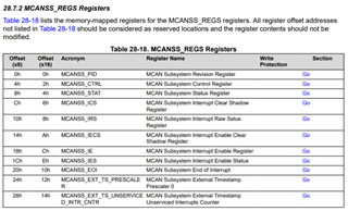

I noticed that the register address offsets for MCAN are inconsistent between the TRM and the C2000Ware library (hw_mcanss.h, version 5.04 that I'm using). Based on my experiments, the definitions in the library appear to be correct, while the offset values in the TRM seem to be half of those defined in the library.
I would like to confirm with TI whether this is a typo in the TRM regarding the offset values.

    After reviewing your query, I noticed a potential discrepancy: it appears the (x16) and (x8) offset values may have been transposed. Specifically:
    - The header files are showing the 8-bit access offset
    - The screenshot you provided displays the 16-bit access offset
    This mismatch could be the source of confusion. Once you provide the device details and TRM reference, I can verify the correct offset values and help resolve this issue.

    Thanks for providing this information. This does look to be an issue with the TRM documentation. I will file a ticket to ensure this issue is addressed in the next release. Please refer to the header file data in the meantime.
