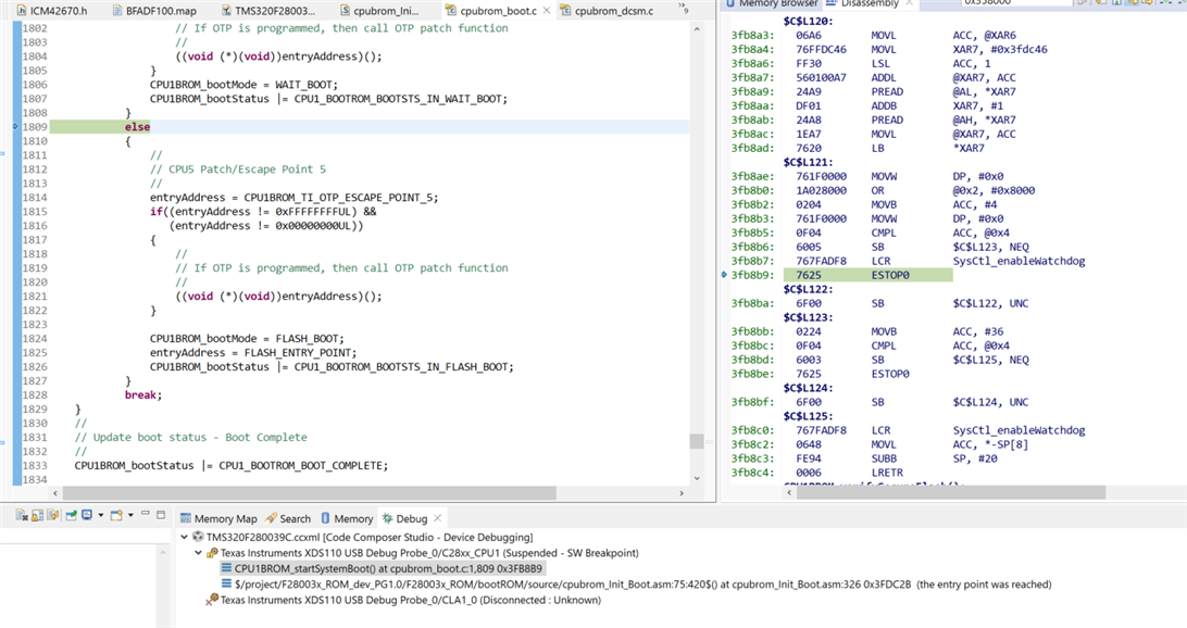

TMS320F280037C: disable boot mode pins and boot from flash
Part Number: TMS320F280037C
I am trying to run with zero boot mode pins (example in 4.5.2.1)
I have programmed z2-GPREG1 to 5aFFFFFF and z2-GPREG3 to FFFFFF03.  The program is getting hung up in the boot ROM by the ESTOP0 at address 3fb8b9, which, according to table 4-19 in the TRM indicates "In Wait Boot Mode". The address pointed to by the long branch at 0x80000 points to f280037_codestartbranch.asm.  If I jump to that address (0x81ef9) and click run, the program executes as expected.
Why am I getting stuck in wait mode?
Don
  • Hello Don,
    Your boot configurations look correct.
    Is the codestart for your application allocated for 0x80000 in your linker command file (.cmd)?
    Matt
  • It is.  After hitting the ESTOP I use the memory browser to get the address loaded at 0x8000. I cut and paste that address into the memory browser, hit enter, right click and select "move to line"  then run.
    Can you share your application's .map file?
    Matt
  • Sure
    Don

  • I'm not sure what was expected but it runs to an ESTOP at 0x3f8B9.  FWIW, when I single-step through the disassembly, the source code doesn't match, much of the time its stepping through comments.
    Reset goes here:
    It seems like the boot ROM symbols are outdated in the C2000Ware release, I've taken action to have this resolved.
    Can you check the following register for me after hitting resume and hitting the ESTOP?
    • Boot ROM Status at address 0x2
    Boot ROM health and booting status is written to a 32-bit address in M0RAM. You can refer to Section 4.8.12.1 Booting Status in the TRM to see the details of this register.
    Also, can you check the "CPU1BROM_bootMode" variable to see what boot mode is decoded?
