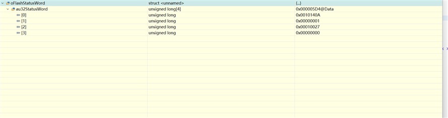

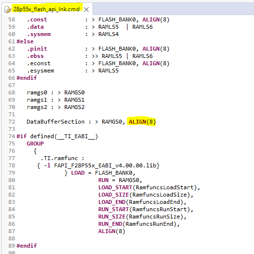

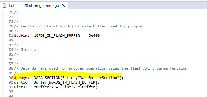

I see in the flash API document, the data buffer of Fapi_issueProgrammingCommand() function must be 128bit aligned, no matter how many bytes that customer needs to program into flash.
Now there is a related issue: customer uses a 64 bits buffer in the Fapi_issueProgrammingCommand() API, the Fapi_doVerify() will report the "fapi_error_fail" issue after call the Fapi_issueProgrammingCommand() twice. there are two questions:
Why this issue reported when the data buffer is 64 bits aligned?
Is there any workaround to support customer keep the 64 bits alignment data buffer but solve the issue?
