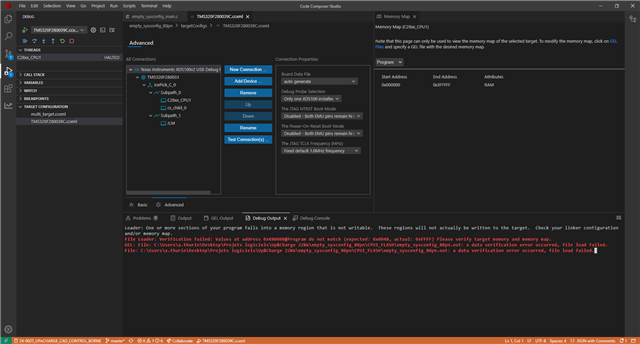

I need to make a test program for one of our projects. I created a new program using the project wizard, with target F280033 and selected example empty_project_80pn, which corresponds to my target. Then I edited the sysconfig file as needed (changed only a few GPIO default state).
I first programmed with the RAM build, and it worked. But then, I tried to program it with the FLASH build, and got the error :
File Loader: Verification failed: Values at address 0x080000@Program do not match (expected: 0x0048, actual: 0xFFFF) Please verify target memory and memory map.

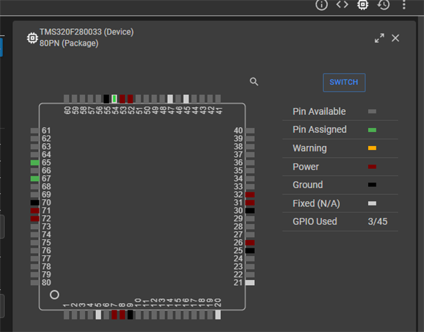

The sysconfig configuration is correct for the target, so is the target configuration file.

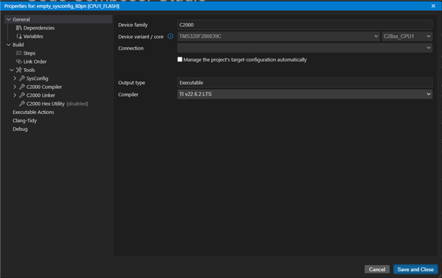

However, when I look at the project properties, I see that the project was configured automatically for the wrong target :
For some reason, I can't change this. I have tried to edit directly the .cproject file, but it reverted to the original setting.
How can I fix this ?
I am a bit worried, because the actual (non-test) code for this project was first developed for the launchpad, and will have to be migrated to an F280033 target too, and I fear I will run into the same issues.
Thanks in advance for your help,
Adrien

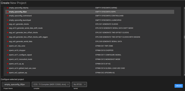

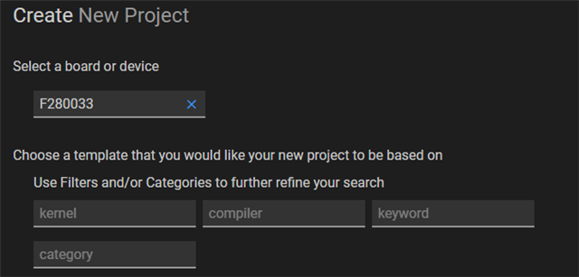

    Thank you for bringing this to our attention. Can you please help provide the C2000Ware version you are using, CCS version, and SysConfig version (within CCS install path > ccs > utils) so that I can look into this issue more closely?
    Where did you see this example?

    • C2000Ware 5_05_00_00 (where I found the example)

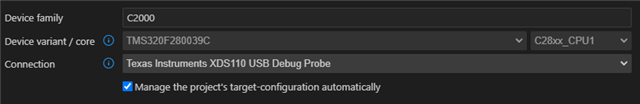

    And once the project is created, in the project properties :
    Clicking on the arrow in the box for "TMS320F280039C" does nothing at all.
    That being said, I am not even sure that's the issue...
    Adrien

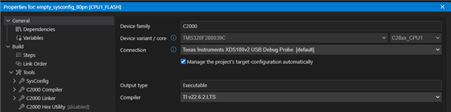

  • Hi Marlyn,
    I forced Sysconfig to version 1.24 in the project properties.
    I still can't change the device / variante to F280033, it is stuck to F280039C. And the error remain.
    Sysconfig is seems to be properly configured though.

  • Hi Marlyn,
    CCS got an update, I deleted the project and created a new one with the new toolchain (C2000Ware 6.0). Unfortunately, the issue remains the same :
    When I go in the project properties, the variant is still stuck to F280039C instead of F280033

  • Hello Adrien,
    I would need to confirm this but I believe that the device shown in the device variant does not update to show the change made to the sysconfig project. What the device is configured for in the sysconfig file should be what is relevant here, along with the dependent files generated by sysconfig.
    I would focus on the data verification error. There looks to be a mismatch between the information in the linker command file and the debugger memory map. Can you confirm that they line up correctly?
    ki

  • Hello  Ki,
    At first glance, it seems to match.
    Here are the files :

  • Where can I find the debugger memory map, please ? I am not sure what you are refering to.
    Please see: https://software-dl.ti.com/ccs/esd/documents/users_guide_ccs/ccs_debug-main.html#memory-map-view
  • Hi Ki,
    The document says "When connected to a target, you can view the memory map in Code Composer Studio". However, I can't connect to the target in debug mode, since it stops before, at the program loading stage.
    Adrien
  • However, I can't connect to the target in debug mode, since it stops before, at the program loading stage.
    You can do a "manual launch" to launch a debug session and connect to the target without loading a program:
    https://software-dl.ti.com/ccs/esd/documents/users_guide_ccs/ccs_debug-main.html#manual-launch
  • Hi Ki,
    I have tried to follow the procedure for projectless debug. I started the project-less debug, connected the target. The memory map showed ... not much. Then I tried to load the code, and again, it failed.
    On top of my colleagues that will soon be stuck, my client has announced he will be visiting next week to run some tests in our lab. I really need to get this issue sorted.
    Adrien
  • It looks like the memory map is not enabled (everything set to RAM) so the debugger itself is not blocking access.
    Are you using the f280033.gel startup file? Regardless, for both the f280033.gel and f280039.gel have flash bank 0 at 0x80000. The failure is saying that you loaded the program and the program is expecting 0x48 to be written to 0x80000 during the verification step but it did not see that value.
    I tried loading the same example from C2000Ware. Using a similar environment but using an F280039C, I did set my target configuration for F28033 however. In any case the program load/flash was successful and you can see that 0x48 was eventually written to address 0x8000 (note that both "Program" and "Data" page map to the same memory location). Do you not see this happen when you load the program?
  • Hi Adrien and Ki,
    I was able to try this on an 80pin F280033 part today. I too see the same verification error. I changed the target configuration to F280033, the project is also using the f280033.gel file, and I modified the cmd file to remove all of the flash banks that the F280033 variant does not have access to (as it has less flash than the F280039 and other variants). However, I still see the issue. I need to debug this further. Will provide an update tomorrow.
    Marlyn
  • Hi Ki and Marlyn,
    Here is a recording of what I am doing. Maybe there is something wrong ? If so, I can't see it.
    it is using teh f280033.gel file. I have tried to change the path for the gel file in the ccxml, to use an absolute path (just in case the relative path had an issue), but the result is the same.
    Does that help ?
    Adrien
  • I was able to try this on an 80pin F280033 part today. I too see the same verification error.
    Thank for trying this! The closest device I had was the F280039C controlcard which seems to be ok.
    Adrien - I will defer to Marlyn here. I don't have the device expertise (or the device itself) to investigate further.
