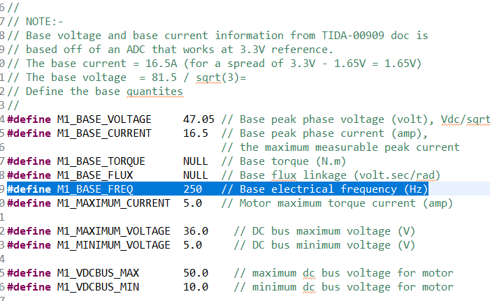

I am using the code of dual_axis_servo_drive with LAUNCHXL-F28P55X and BOOSTXL-3PhGaN.
--------------------------------------------------BACKEMF-----------------------------------------------------------------------------
I have a motor with 93Vrms/kRPM but I need to convert it to V/Hz to set parameter M1_KB (BEMF Constant).
   - If your "V" in "V/Hz" is Vrms, the value is 93.3/1000*60 = 5.598
   - If your 'V' in 'V/Hz' is intended as Vpk, the value is 93.3/1000*60*sqrt(2) = 7.917
Which of the two cases?
--------------------------------------------ELECTRICAL FREQ--------------------------------------------------------------------
Should I change M1_BASE_FREQ in the picture below?
What does it mean?
I remember that in the motorware there wereUSER_MOTOR_FREQ_LOWUSER_MOTOR_FREQ_HIGHUSER_MOTOR_FREQ_MAXUSER_MOTOR_VOLT_MINUSER_MOTOR_VOLT_MAX
which had to be set 10% and 100%-120% of the motor rated frequency and voltage ... I cannot find these parameters any more

    • Electrical Freq
      • M1_BASE_FREQ represents the maximum target speed you intend to bring the motor. In a per-unit representation, SpeedRef_Hz = 1.0 represents a target motor speed of M1_BASE_FREQ.

    3) "M1_BASE_FREQ represents the maximum target speed you intend to bring the motor" .. so in my case I want 250rpm maximun --> M1_BASE_FREQ = 33.33Hz since 16 poles of the motor.
    Why is used the per-unit representation?

    • A per-unit speed reference of 1.0 represents a target speed of 33.3 Hz
    • A per-unit speed reference of 0.5 represents a target speed of ~16.6Hz
    • etc.
