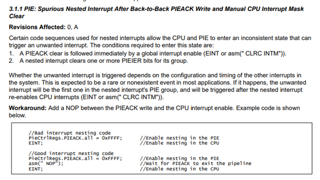

    4. I have also noticed that if i let it continue running, then other spurious interrupts occur. I see interrupt 40, 23, 64. 40 and 64 are the first interrupts in groups 2 and 5, and 23 is an odd user defined interrupt which we dont use.
    I have found that the silicon errata COULD explain the issue. I have implemented the fixes described in here, but this does not fix the issue.
    Errata TMS320F28P55x Real-Time MCUs Silicon Errata Silicon Revisions A, 0
    SPRZ572B – APRIL 2024 – REVISED FEBRUARY 2025
    One thought is that these are early uCs with issues, as this is still quite a new device. According to the PARTIDL register, my uC is an engineering sample. Is it possible to source uCs from TI that are full production samples, to rule out whether it is a silicon issue?
  • Hi Emily,
    Thank you for your response. I can't see which Errata you have linked but is it the below?
    If so, this would only apply for a interrupt nesting implementation. Have you enabled nesting in your application at all? If so, can you show me how you did the ISR code (this has to be done in a very specific way)?

    So, firstly after pressing on with the rest of the ISR/UART configuration, I noticed that some critical section code was implemented incorrectly. The code was wrapped by two critical section enter calls, without an exit. Fixing this, the spurious interrupt issue appears to have gone away. Nonetheless, I intend to return to this later on to confirm this behaviour, as there does appear to be some other interrupts being triggered seemingly without cause.
    In response to your last post, we do not implement nesting interrupts, however I defensively added the EDIS to the end of all interrupts as mentioned by the errata.
