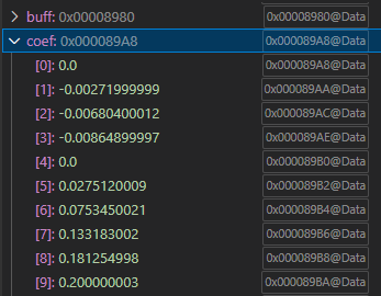

When I build with optimizations enabled (C2000 TI v22.6.2.LTS), I see that the compiler tries to optimize this loop using MMACF32 || MOV32 instructions.
However, because my arrays buff[] and coef[] are placed contiguously in memory (buff ends at 0x89A6 and coef starts at 0x89CE), the first instruction that reads buff[19] uses an MMOVD instruction. This instruction not only reads but also writes the value to the next memory location, which ends up overwriting coef[0] with buff[19].
As a result, my coefficients get corrupted.
Here you can see the coefficient loaded:
float aux_coef[20] = {  -0.000424f,
                            -0.002720f,
                            -0.006804f,
                            -0.008649f,
                            0.000000f,
                            0.027512f,
                            0.075345f,
                            0.133183f,
                            0.181255f,
                            0.200000f,
                            0.181255f,
                            0.133183f,
                            0.075345f,
                            0.027512f,
                            0.000000f,
                            -0.008649f,
                            -0.006804f,
                            -0.002720f,
                            -0.000424f,
                            0.0f};
and the coefficient after running the code:
Question:
  • Is this behavior expected with MMOVD when arrays are back-to-back in memory?
  • Is there a recommended way (pragma, compiler option, or memory alignment) to prevent this overwrite when using CLA optimization?
Thank you!
Sebastian Glas.
  • This code from the readme ...
    interrupt void Cla1Task1 ( void )
          result = 0.0f;
          int16_t i;
          #pragma UNROLL(20)
          for(i = 20; i > 0; i--)
               buff[i] = buff[i-1];
               result += coef[i] * buff[i];
          result += coef[0] * buff[0];
    ... performs 21 multiply-accumulates, not 20.
    Here is another way to think about it.  The first iteration of the loop writes to buff[20].  For that to be a legal access, you have to write the definition of buff as ...
    float buff[21];  /* or higher than 21 */
    You could also write the loop to count down from 19, instead of 20.
    Thanks and regards,
    -George
