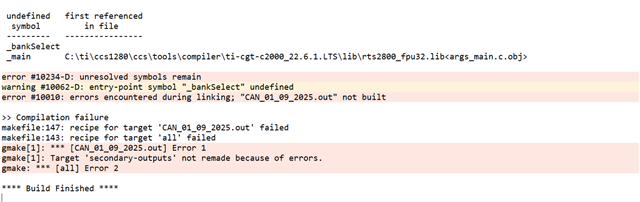

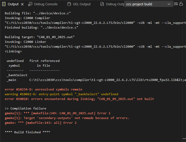

  • Hi Charles,
    I was looking at the DCAN_Boot.c source file inside the BootROM source folder.
    I have a doubt: is this the main file?
    Even after adding the supporting libraries, it's still giving compilation errors.
    What could be the issue?
    Do we need to map the memory manually?
  • Hi Nibesh,
    This is a main support file for the ROM bootloader, but for your project it should not be used solely as the main file but as a reference. If we look at the flash_kernel_ex5_dcan_flash_kernel project, you can see this file is included as a part of the project's build, but the main source file used is called flash_kernel_ex5_dcan_flash_kernel.c . Can you give an image of the compilation errors?
    The memory mapping should be handled by the linker command file for the project and may need to be modified as well.
    Thanks and regards,
    Charles

  • Hi Nibesh,
    From first import and rebuilding of the project, it gives the following error for "_bankSelect" symbol being undefined:
    As well, in the code I am seeing quite a few lines that use the "Escape point for OTP patches". This functionality should primarily be used by the bootROM source and should not be added to your CAN Flash Kernel.
    I advise that the source for this project model something closer to the F28003x Flash DCAN Kernel example in terms of structure.
    Thanks and regards,
