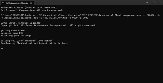

  • Hi Skyler,
    Yes, I am using Visual Studio.
    Actually, there was a mistake on my part—I'm using Visual Studio Code, not Microsoft Visual Studio.
    I've now downloaded Microsoft Visual Studio, and I'm able to compile the project. After compiling, I get the application file in the Debug folder.
    I'm using serial_flash_programmer.exe to upload the code with the following command:
    serial_flash_programmer.exe -d f28004x -k flashapi_ex2_sci_kernel.txt -a led_ex1_blinky.txt -b 9600 -p COM3
    However, it's unable to detect and upload the program.
    What could be the issue?
  • Hi Nibesh,
    Are you sure that is the correct COM port? Have you put the F28004x in the SCI boot mode? Are you connected to the proper GPIOs configured during the SCI boot mode?
    Kind regards,
    Skyler
  • Hi Skyler,
    The COM port is correct.
    I have not configured the GPIO for SCI Boot mode.
    Is it necessary?
    I am following the datasheet SPRUIU8A – March 2020 (Revised August 2021). According to this document, SCI bootloading does not require switching the GPIO pins. It seems to work without changing the boot mode.
    In SPRUIU8A, they are using the following command for the operation:
    serial_flash_programmer_appln.exe -d f28004x -k flashapi_ex2_sci_kernel.txt -a led_ex1_blinky.txt -b 9600 -p COM3
    However, after compiling the project using Microsoft Visual Studio, we are getting an executable named serial_flash_programmer.exe, not serial_flash_programmer_appln.exe.
    Could you please explain the difference between these two application files?
    I look forward to your response.
    Thanks and regards,
    Nibesh
  • Hi Nibesh,
    When configuring the SCI boot mode, the F28004x sets some GPIOs as SCITX and SCIRX as part of the SCI boot flow. You need to make sure that you are sending the data to the proper pins on the board such that they match the configured GPIOs. From table 4-29: SCI Boot Options in the TRM, you can see that the default SCI boot pins are FPIO29 and GPIO 28. I recommend taking a look at this application note to get familiar with these concepts.
    The serial_flash_programmer_appIn.exe is simply the serial_flash_programmer project compiled with the #kernel macro commented out on line 242 of serial_flash_programmer.cpp. By commenting this macro out, the programmer will not send the kernel file over SCI and will assume that the kernel/bootloader is already loaded and running on the device. We rename the exe in the SDK to differentiate the two executables.
    Kind regards,
    Skyler
