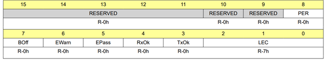

    1.What is the CAN error status on DSP2 side?
    The last error status is 111.

  • Thank you.
    The TxOK in the screenshot is 0 which means that no message has been successfully transmitted since last time when this bit is read by the CPU.
    Have you measured the signal waveform on CAN bus when DSP2 is transmitting message to DSP1? Any CAN controller may start a transmission when it has detected an idle bus. This may result in two controllers on DSP1 and DSP2 starting a message (almost) at the same time. Since the bus is wired-and and a Dominant bit is logically 0, it follows that the message with the numerically lowest Arbitration Field will win the arbitration. The MSG ID on DSP1 is 0x1 (0x2 on DSP2), so the MSG on DSP1 will be transmitted.

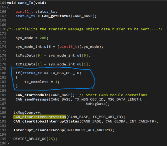

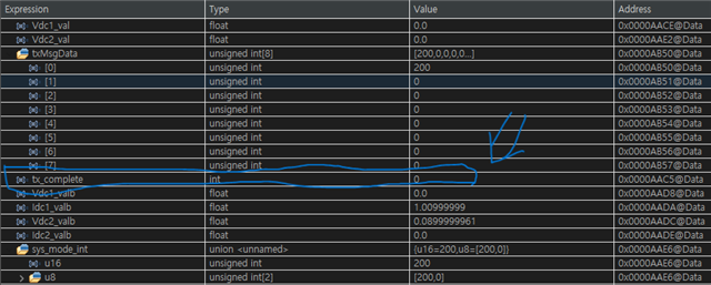

    Thank you for clarifying the fundamentals. In the transmitting code on DSP2, I am using a variable (tx_complete) to monitor the transmission status, but it remains at zero. This seems to indicate that the transmission is not completing. Please correct me if I am wrong. I have attached screenshots for your reference.
    Thanks and best regards,
    Mohammad Sameer Irfan
  • This seems to indicate that the transmission is not completing.
    From your code, you are correct, the transmission is not completed. Is the errorFlag set?
    Can you comment out the code (highlighted below) in your canbSIR() since reading LEC will reset this field to 0x7?
    You can add a breakpoint in canbISR() to make sure there is interrupt happened. Thanks
